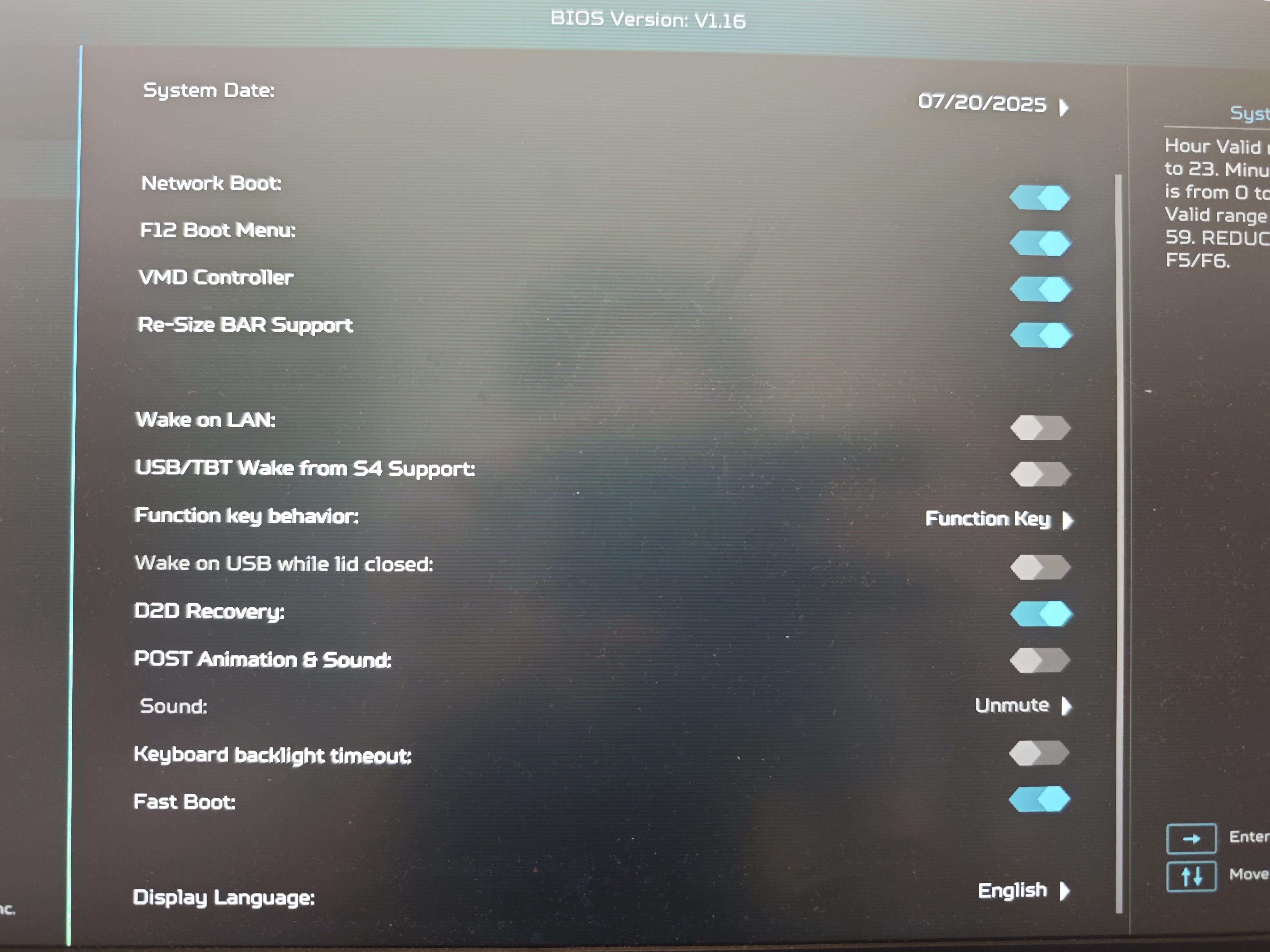

    On the BIOS Settings where can i find the SATA mode set to RAID? i don't see it
    My VMD is already activated but i still didn't see the settings to to change SATA to RAID
  • Puraw
    Puraw ACE, Member Posts: 17,985 Trailblazer
    Hi, press Ctrl+S in BIOS-Main to show the hidden settings.

    Thanks for confirming VMD is already active. On the PHN-1672, the usual trick to reveal hidden SATA/RAID settings is pressing Ctrl + S while on the Main tab in BIOS. If that doesn’t expose the options, it’s possible your BIOS version doesn’t support toggling between RAID and AHCI — especially on builds where Intel VMD handles storage directly.
