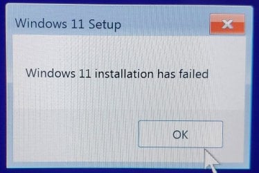

My laptop had gone very slow so i decided to perform Windows 11 Clean install, just like my other Laptop. But i encounter a problem where when i tried to install it keeps failing like on this image:

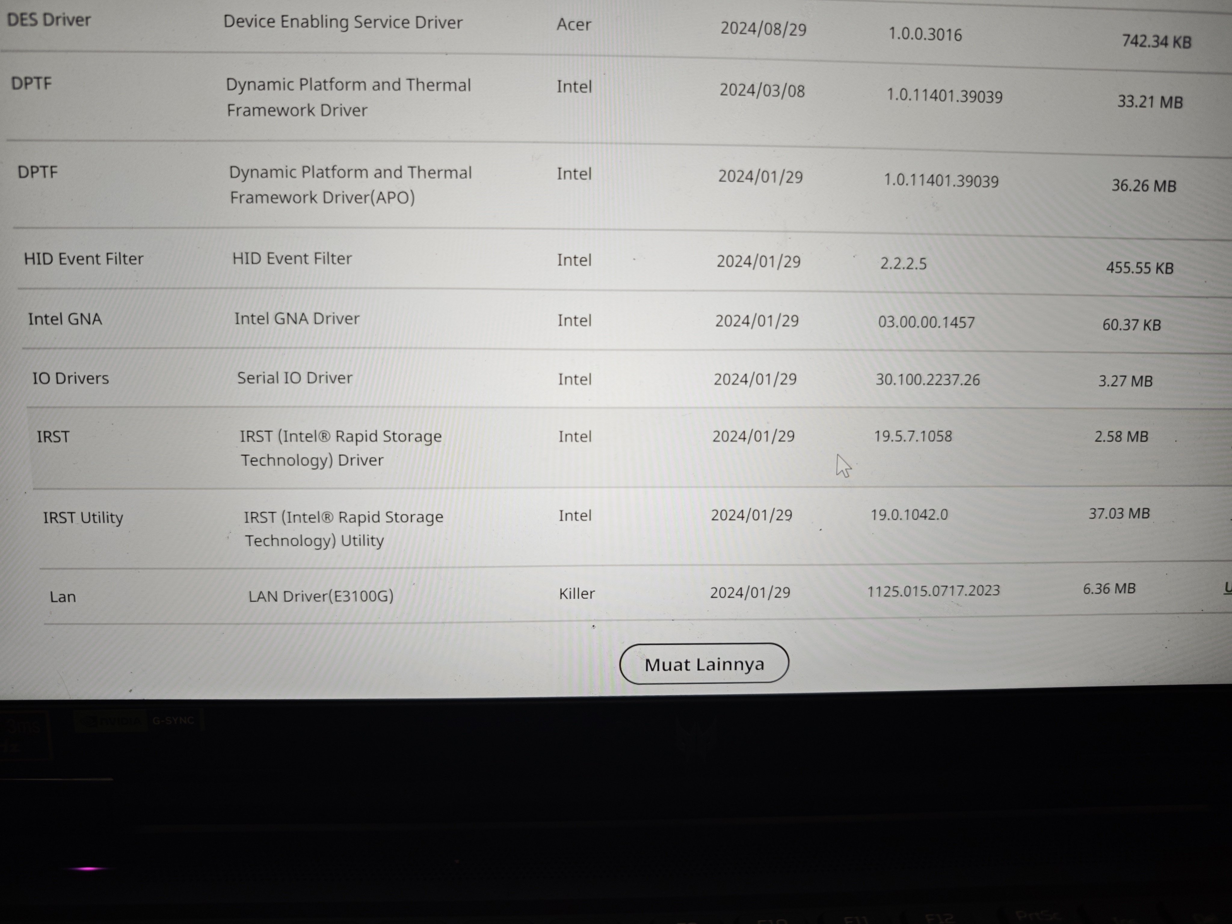

I already downloaded the correct IRST from the driver listed on my product. So i don't know what is the problem here?
Some additional info, My laptop model is PHN-1672-57J0 and im trying to install it on a brand new SSD i bought. WD BLACK SN850X 2TB
