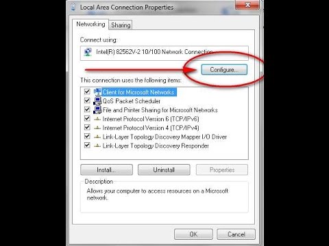

    Take a look at the following settings and see if the solution solves your problem:
    Also, are the games set for permission on the antevirus and the firewall?

    About first picture, as I said, I did it.
    I cleared that checkbox in the second picture earlier.
