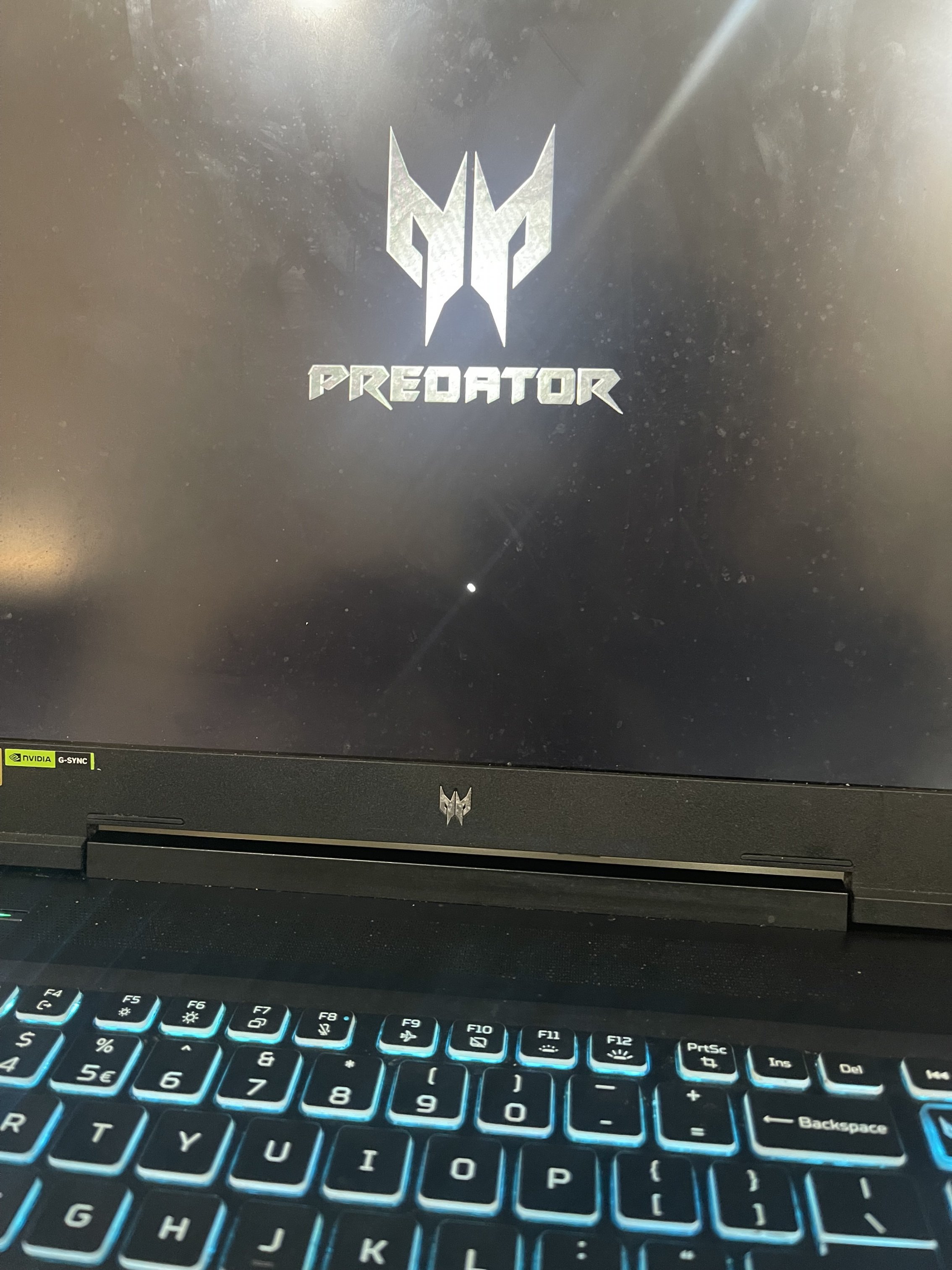

My Predator Helios Neo 16 has been freezing everytime i turn on the power button and after a few times it leads me to this blue screen. Pls help me on how to figure this out.

  • FendiChanelDior
    FendiChanelDior Member Posts: 2 New User
    it still wont work after everything now its not opening anymore.. its just stuck in the freezing symbol
