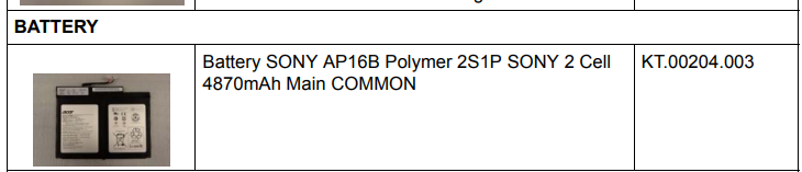

    But anyway, if you want a battery replacement, I suggest that you take your tablet to a local mobile phone tech that changes batteries as they would be able to do this job Easley and much cheaper than Acer tech support.
    This is the SA5-271 battery listed by Acer in its service guid, so try and get this battery on eBay and supply a local tech with your tablet and battery so they can replace it.
