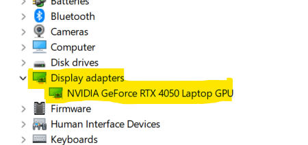

    Do this and see if it works, you need to uninstall all the AMD Navi 3 graphics with up to 6 WGPs cpu graphics drivers from the AN16-41 laptop, as then the bios > Optimus will not witch to the AMD cpu graphics, as there is no drivers.
    This is how your Win-11 Device Manager should look like within your AN16-41 laptop with NO AMD cpu graphics driver installed:
    What is happening in your Nitro AN16-41 laptops is that and if you have both the AMD cpu graphics drivers and the NVidia drivers installed, the laptop switches automatically to the lower power AMD cpu graphics to save battery and when you play games it switches to the NVidia graphics automatically and that is where the freezing and crashing happens.

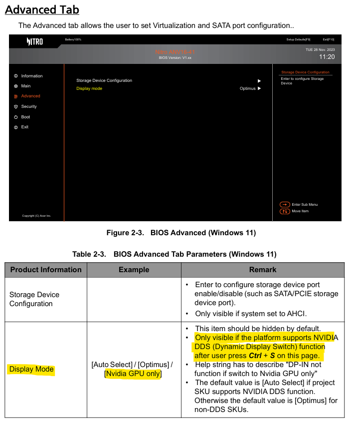

    What I suggest is that you go to the bios and set the bios to the Advanced > Display mode > NVIDIA GPU only settings and only have the last RTX4050 NVIDIA game Ready driver version 577.00 installed on this laptop as then your AN16-41 will not freeze or crash and it will work perfectly with the NVIDIA RTX4050 GPU only, which is the best gpu for this laptop to work with and NOT use the AMD cpu graphics. Try that and let us know. make also sure that you have the Win-11 version 24H2 updated to the last OS build: 26100.4770 that I found that has improved the Win-11 performance too and of course the AN16-41 last bios version 1.25 installed too.
    Set your Nitro AN16-41 in its BIOS > Advanced > Display mode > NVIDIA GPU only settings
