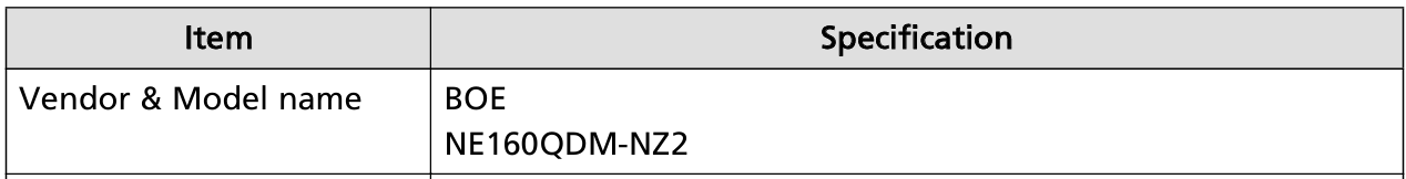

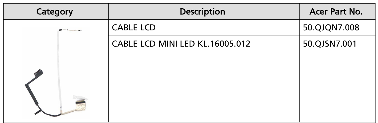

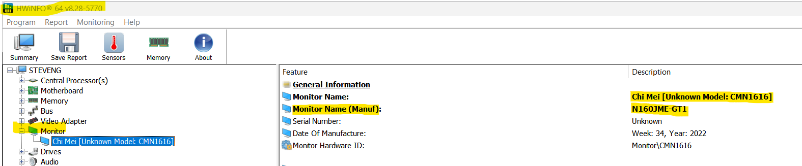

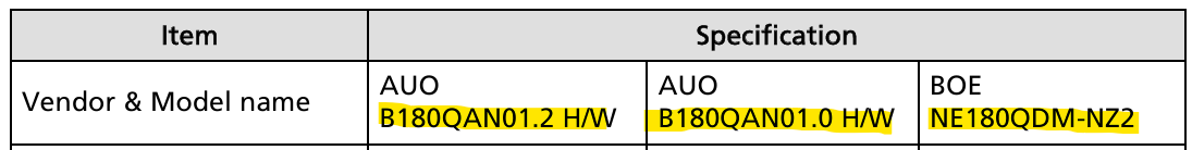

    These are the parts you need and what you should do for your PH18072 model laptop that you have. To get the exact 18 inch model screen that you have, install the HWiNFO64 software and look under its Monitor section for the specs of your PH18-72 laptops screen model, I've also included the eDP cable. Good luck and hope this helps you out further.
    This is the screen that is fitted to my PHN16-71 model laptop shown with WiNFO64 as an example to you only:
    eDP cable
    18 inch screen Acer fitted to the PH18-72 laptops.

    Your instincts are spot-on — this really does sound like a bad eDP cable. The fact that pressing or adjusting the lid temporarily restores the display is a classic sign. Even if the plug looks properly inserted, it might be slightly misaligned or the cable damaged internally. Replacement is possible, and DIY is doable with caution. Look for the PH-72 compatible Mini LED eDP cable — part numbers are tricky, so sourcing it from a reputable vendor or Acer parts distributor is key. When replacing, take care not to overbend the cable during reassembly, especially near the hinge.

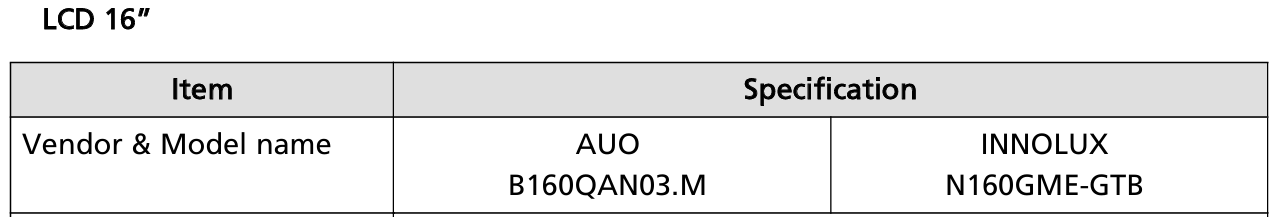

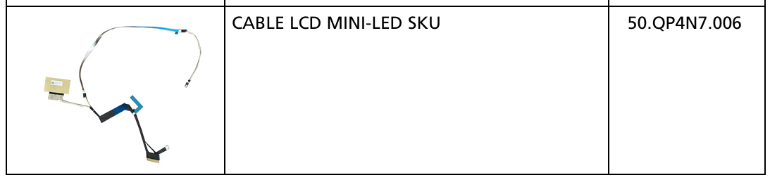

    If your Predator Helios laptop is the model number PH16-72 (as there is also a PH18-72 model which is an 18inch laptop) then the below parts is what you need, so buy these parts, but first establish that its the eDP cable or the screen.
    LCD 16 inch screens fitted to the PH16-72 model laptops
    eDP cable
