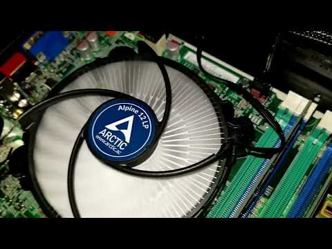

    Remove the backplate as in this video. I still would prefer to use the screws for a much more solid mounting.
    https://www.youtube.com/watch?v=vf18PhvFbBs

    The video is a case of perfect fit CPU cooler.
    I only have a TC-885 PC and no expereiences with the Acrtic Alpine 12 LP cooler to duplicatre the issue. Hope @chumbo's DIY can sort out the issue and report back.

    As for the video...do you know for a fact that there is a backplate on the Acer MB or are you just guessing/presuming so? The photo I took of the screw was done with an endoscope which I also used to explore the thin space between the case and MB and although it was hard to see, I didn't notice anything like a backplate?
    I think those screw fittings I showed on my previous photo are built in the case or MB and don't look to be removable 😒.
    I certainly am in no mood to remove the MB as it would be a real PIA to do! Yes, maybe only a few screws but due to how space is managed inside the case, it would involve taking it apart completely, beyond just the few screws holding the MB to the case. I'm looking at possibly a good hour to remove and put it back and possibly for nothing so...I'm going to pass on that.
    My next option is replacing only the fan which appears to be attached with 4 standard screws much like any other fan I've seen before but that's the thing...will Acer have another surprise up it's sleeve and reveal it doesn't take 'standard' fan screws!?
    I dread and fear but I'm going to take the plunge and let you know.

    The Cooler Master you linked to has a backplate and as explained, I don't want to have to bother with removing the MB.

    Yes but too risky. I think I'll just set aside an hour and try to install the Arctic cooler since I still have it here with me. I'll go ahead and remove the MB and see how it goes from there.
    Wish me luck 🙄

    So I took out the MB and as expected, Acer had another unpleasant surprise in making things difficult for customers.
    There is a backplate but it cannot be removed! It's really two parts in one. There is the backplate for attaching the cooler and then the backplate of sorts for the CPU attachment.
    And the two are basically one part. The cooler backplate is glued to the CPU 'backplate' which you of course cannot remove unless you're ready for some serious DIY butchery!
    So I will be sending back the Arctic cooler and will be buy just a fan. Arctic recommended the P8 PWM PST which he said is best suited for CPU installation.
    The fan installed by Acer is a Cooler Master FA09025H12LPB so at least that sounds pretty standard (although I couldn't find any detailed specs on it).
