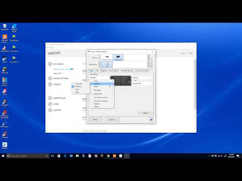

  • there must be some wacom program to adjust the pen, see:
