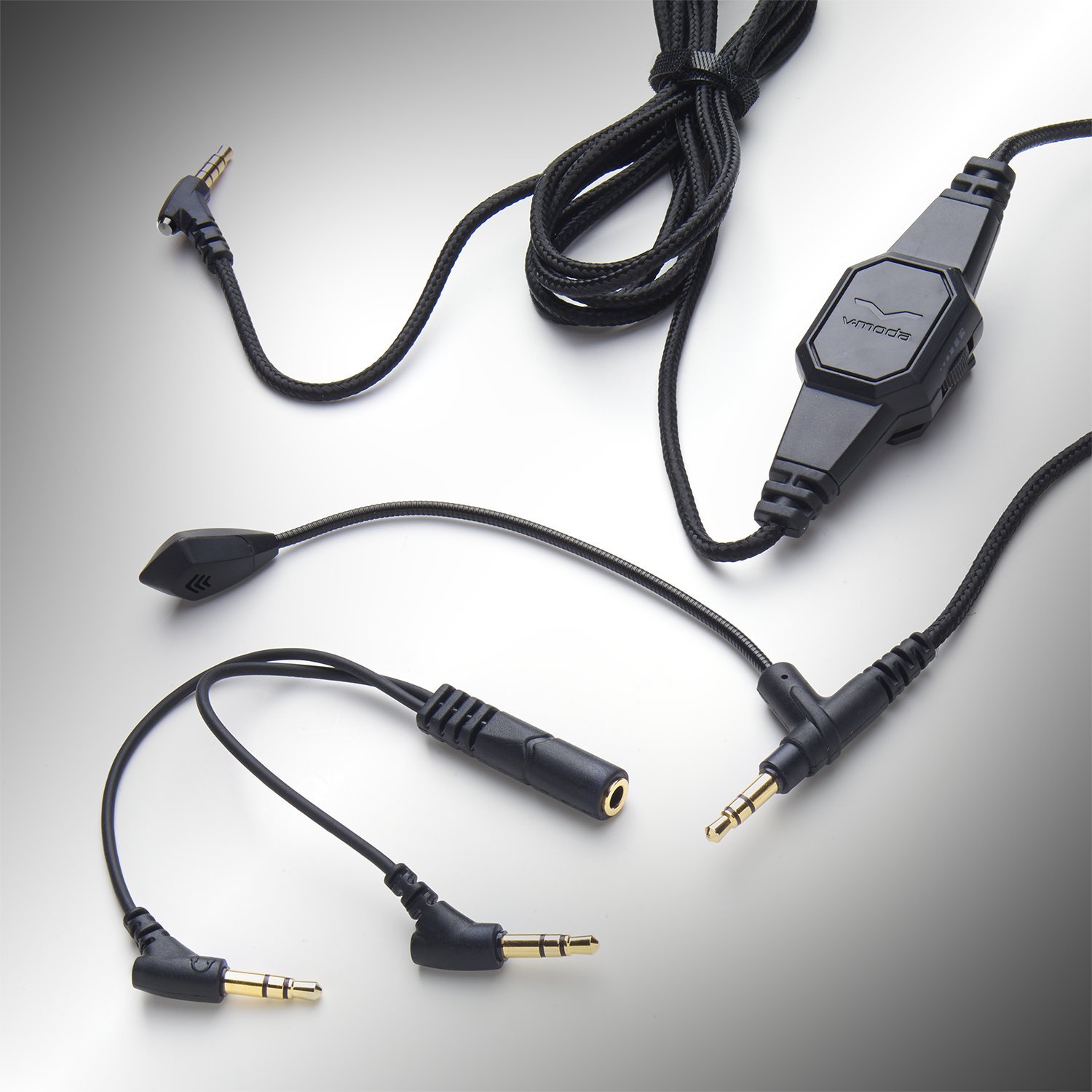

  • laurent_14
    laurent_14 ACE Posts: 10,083 Trailblazer
    May be I'm stupid but I have a little doubt about the adapter shipped with the microphone.
    This one stated in my previous is different.
    Normally 3 black rings, you can directly connect it to the laptop.
    Is it your microphone? Do you use this adapter and how (please take a picture)?
    https://images-na.ssl-images-amazon.com/images/I/71x29UHHD3L._SL1500_.jpg
    France
  • iggs_1
    iggs_1 Member Posts: 23 New User
    My apologies Laurent
    My package is the one in your attached image. I have tried using it both ways, with just a original cord and also with the y splitter that they provide. Both ways unrecognised through my laptop. Should I purchase that adaptor in the previous post even though I have the one they provided?
