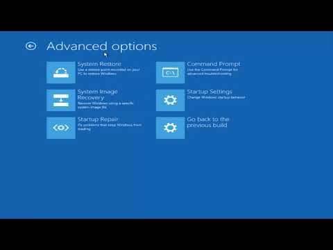

    JackE ACE Posts: 44,330 Trailblazer
    Re-try the ALT+F10 reset procedure again as shown in the video below. If it still fails, then your HDD has likely crashed. New HDDs aren't that expensive any more (about $30USD for a new 1TB HDD) and you can re-load a generic version of Win10 for free from the Microsoft media creation tool site if your system came with factory-installed Win10. Jack E/NJ
