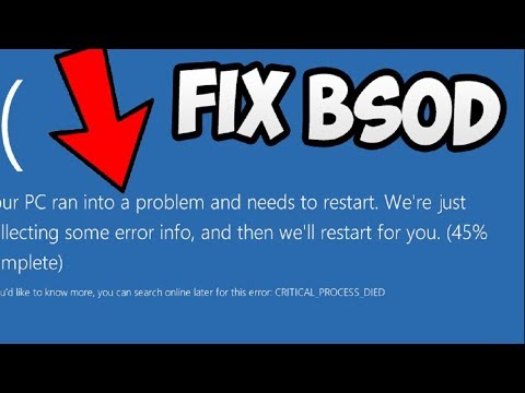

    Hello,
    Please see the attached file that you requested.
    I have now Rest my PC 3 times, and removed everything. Which is so sad and just frustrated. Just because of this image that I attached with this post. But some other few things too.
    This PC RAM is 8GB. NVIDIA GeForce GTX 970.

  • Commodore_1995#
    edited December 2018
    Yes, he will see! Do you have any antivirus like norton installed? Have you checked out this video yet?
    https://www.youtube.com/watch?v=bD4xk0frD4M

  • JackE
    JackE ACE Posts: 45,225 Trailblazer
    Yes, I agree with egydiocoelho
    Uninstall, don't just disable, any nonMicrosoft antivirus like Norton, McAfee, AVG etc. All you need is Windows Defender and Malicious Software Tool which are automatically updated. Let us know how the tips in the video work. Jack E/NJ
