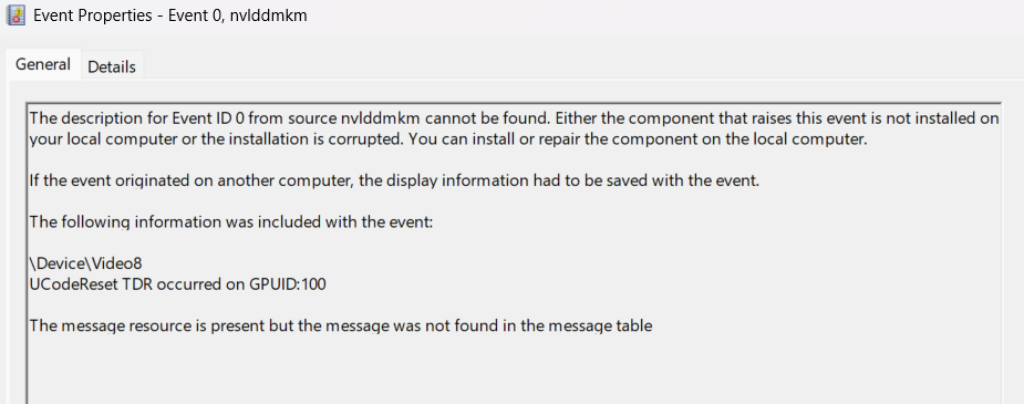

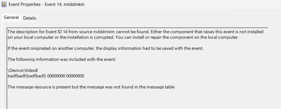

  • BT_90
    BT_90 Member Posts: 5
    Tinkerer
    I have reset the windows, running youtube, Google on chrome and games on laptop plugged in. Still it is same issue for me. Not sure what's happening.
    One more thing I noticed is that I don't have option of windows borderless while selecting the resolution in game launcher. I still think all this is happening due to bad driver but after DDU, Windows reset, installing old driver, installing latest driver as well, nothing is working.

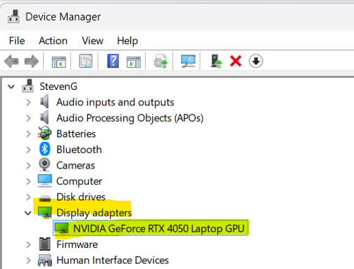

  • StevenGen
    StevenGen ACE Posts: 15,179 Trailblazer
    edited August 10
    Try to do a clean install of Win-11 and start again and do the following, as I've got the exact same model laptop the PHN16-71-50JG with the i5-13500HX/RTX4050 but I've upgraded the ram to 64GB at 2x 32GB DDR5-4800MT/s CL40 and I think that this is why my laptop performs allot better than the same laptops with lower ram capacities over all spectrums and especially in gaming. Make sure that all the Win-11 updates are done and to the last OS build: 26100.4770, update the bios to the last 1.18 version and update the NVidia game ready drivers which for my RTX4050 last game ready Win-11 version driver is the 580.88 and when you install all these graphics divers from NVidia, do a Custom installation > Clean installation as that deletes the previous NVidia graphics drivers.
    These laptops thrive on operating (especially in gaming) with more than 64GB ram and even 128GB or more ram and also operating with the NVidia gpu ONLY setting in bios and Predator Sense, as that is what my setting are and everything is at default in Predator Sense. Also, do not install any overclocking software or try to reduce cpu voltage or modify anything, keep the laptop at default and how Acer has designed this laptop to operate.
    As I've never ever had problems, and in the benchmarking of Unigine_Valley-1.0 I get a benchmark score of 181.7 fps and a score of 8187 at min fps: 38.4 and max fps: 372.6 fps and it runs Future Mark perfectly and GPUz also with great temps all across the spectrum.
