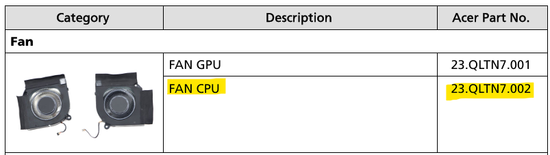

    The beeping could be because of the cpu fan that is not to spec and its affecting temps of the cpu. Replaced the fan with the original Acer CPU listed below for the PHN16-71 model.
    The PHN16-71 CPU fan is Acer part #: 23.QLTN7.002 fan, as this is very important as the EC chip programming is calibrated to operate with the below cpu/gpu spec fans, and any other fan could give problems because they are of different specifications. So if you didn't fit the fan listed below, then change the fan for the proper fan listed below.

    PHN16-71 cpu and gpu fans fitted by Acer
