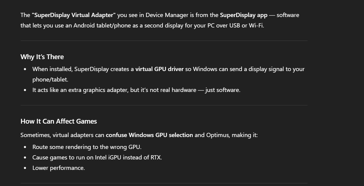

    thank u for your time but i found the problem its due to a software i installed "super display"
