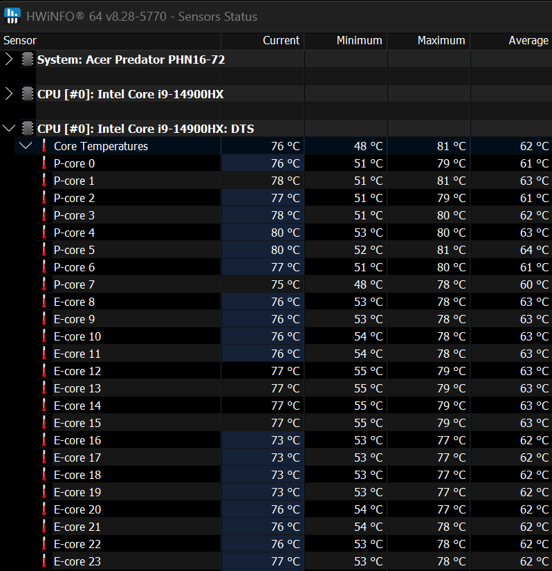

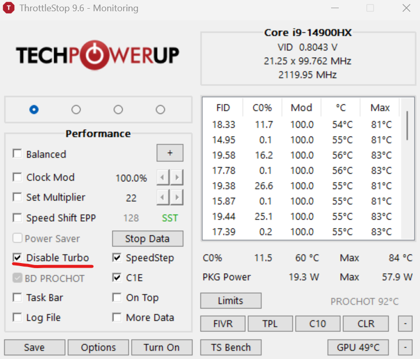

    Hi, I had the same issue with an i9-14900HX, where temperatures reached up to 80°C while idle and 100°C during gaming.
    Here’s what worked for me:
    • Change the Power Plan: Go to the search bar, type Power Plan, and switch to Balanced.
    • Alternative, Disable Turbo Mode: The previous point should take care of this, but in any case you can use Throttlestop. Download the app, check Disable Turbo, and then click Turn On, as in the first screenshot.
    The second screenshot shows me playing Expedition 33 at Epic settings and 60 FPS, with temps staying below 80°C.
    Hope this helps anyone experiencing the same issue
