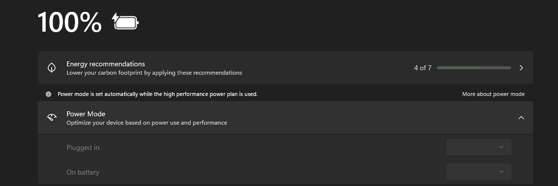

Interestingly, I managed to get it to turn on once by pressing the battery reset pinhole while the charger was connected. It showed 100% and worked while plugged in, but still didn’t charge the battery, and the blinking light persisted even after leaving it plugged in overnight.
