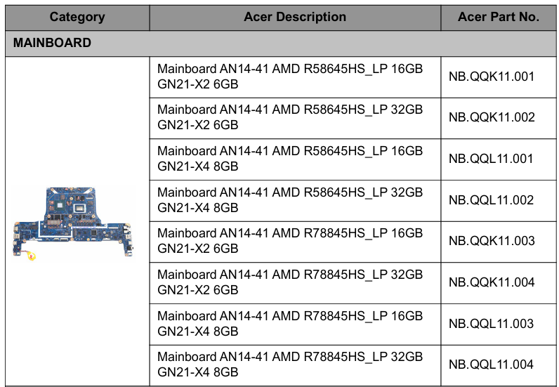

    If your AN14-41 is still under the Acer warranty then I would send your Nitro to Acer Tech Support and get them to change the mainboard as its EC chips controlling the USB Type-C Ports is faulty and what Acer will go is provide you with a new mainboard. Good luck.
    These are all the mainboards that Acer fitted to the Nitro AN14-41 model laptops.
  • JohnTheGamer86
    JohnTheGamer86 Member Posts: 14
    Tinkerer
    thank you very much steven I really do appreciate all your help. Ive liked your contributions as its the least I can do 🙂. I go on holiday in a couple of weeks so I can send to them whilst im away so they can sort it as wont be needing it anyway.
