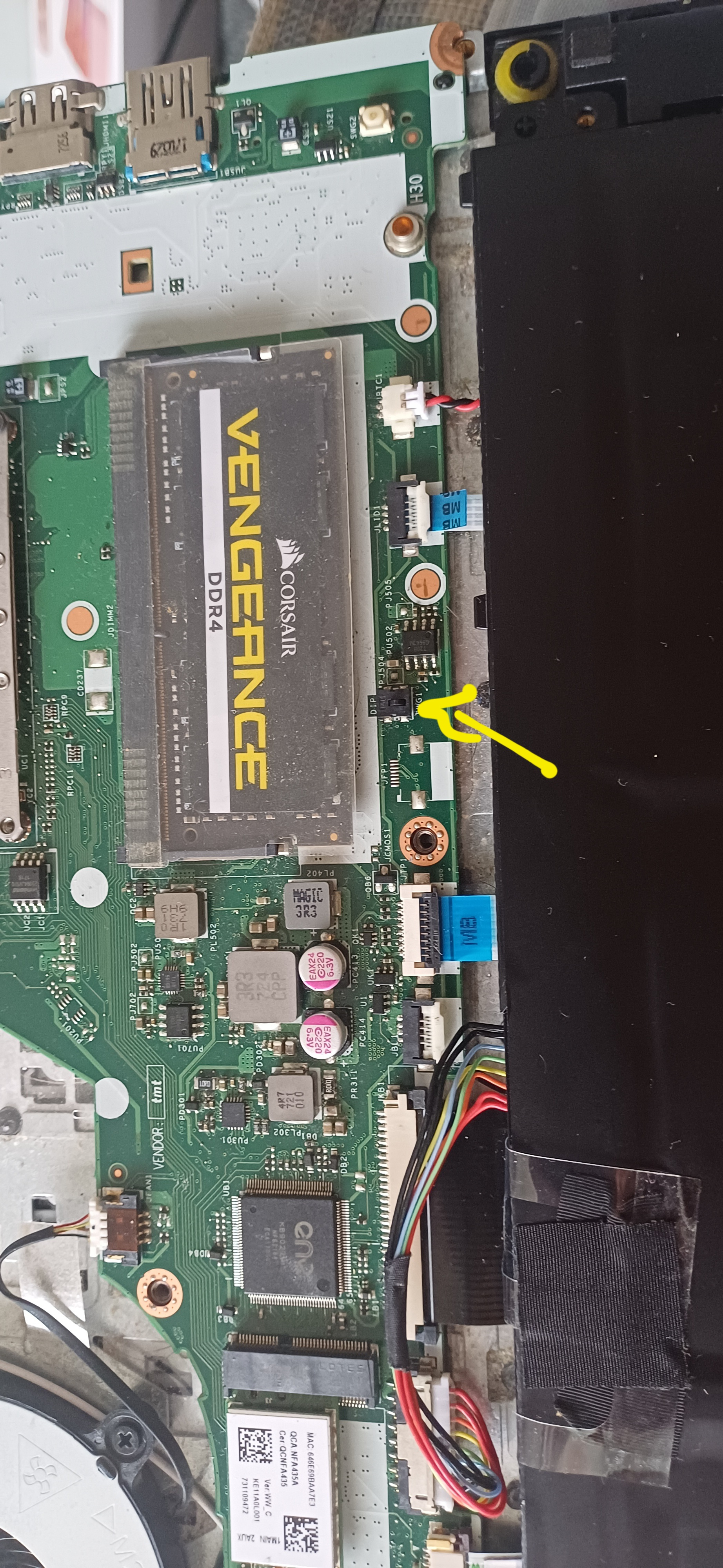

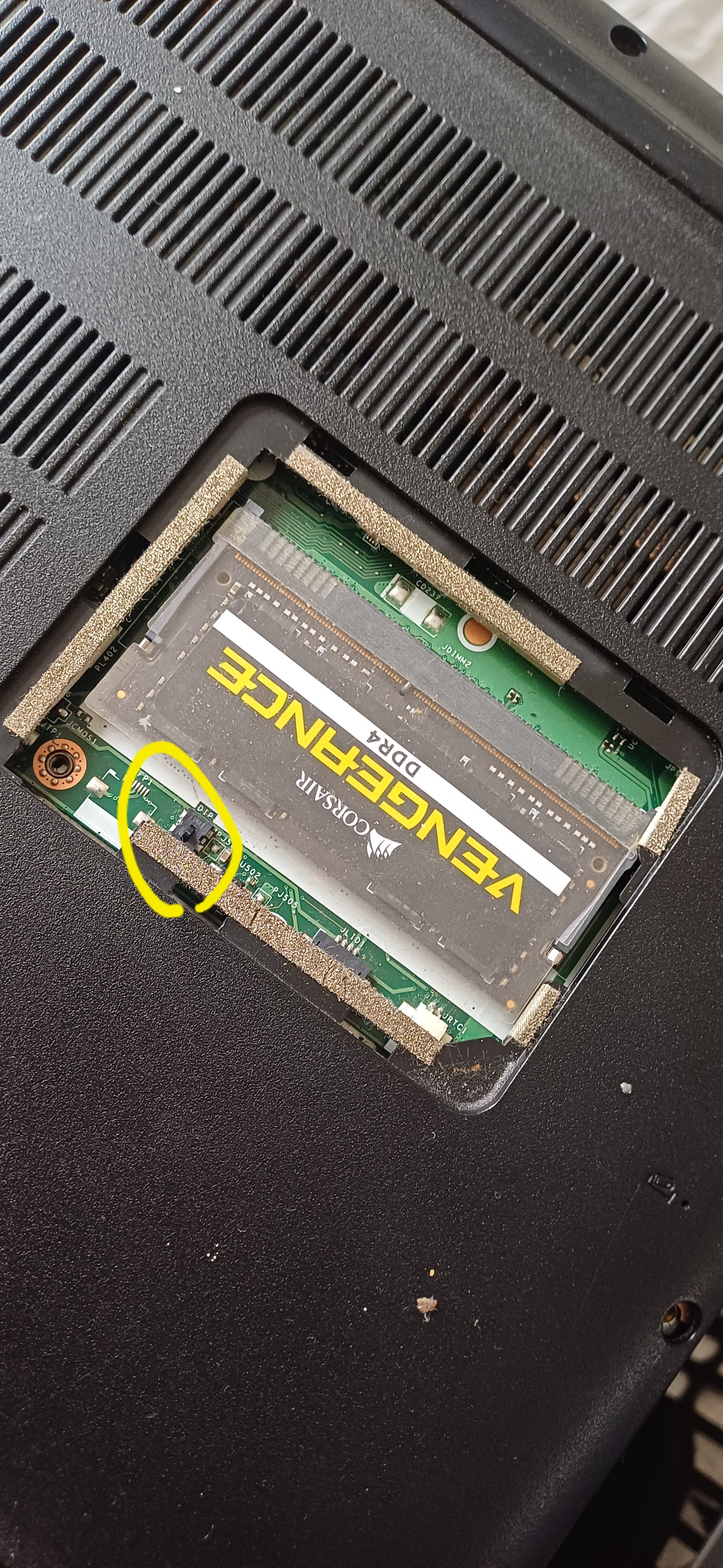

  • tuopi
    tuopi Member Posts: 7
    Tinkerer
    by "button above the" i mean this. its a weird little button thats usually held down by the cover over the ram slot, and apparently stops charge from running whilst its not pressed down. i really dont know why it exists, but it does

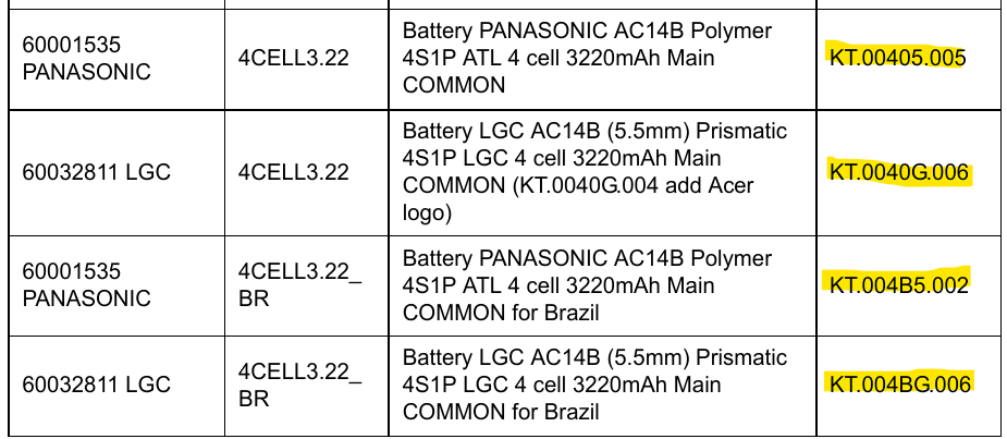

  • StevenGen
    StevenGen ACE Posts: 14,877 Trailblazer
    edited July 14
    That ram door switch problem, could be happening because you have the wrong battery, and a copy non genuine battery, as the oem genuine battery for your Aspire A515-51 should be a 4CELL3.22 Acer part #: KT.00405.005 that is a 3220mAh, 48Wh , 15.2V, Li-ion type battery as that is what you should use for this laptop, as the copy battery is probably an inferior battery and that is why its giving that orange charging light. Change the battery, as those copy cheaper batteries are not worth buying. Good luck and hope this helps you out some more.
    Only use these compatible 4 Cell 3.22 Acer batteries that Acer recommends for your Aspire A515-51 model laptop.
