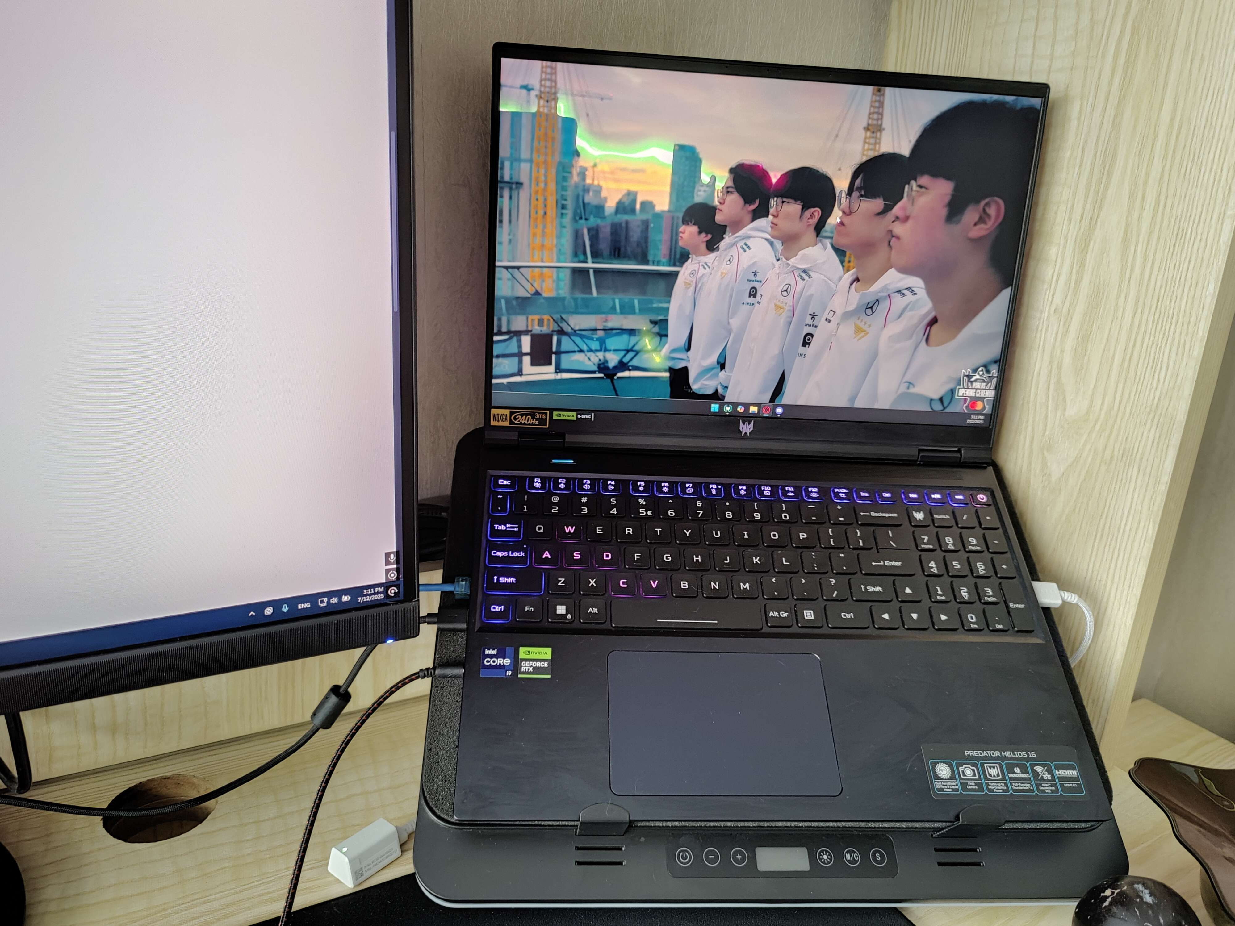

    Environment: My laptop never got much dust after I cleaned it once a year ago because my cooling pad filters dust while cooling. I don't know about humidity, my room is pretty chilly most of the time. Although, I do put my laptop in the corner of my desk(picture)
