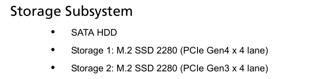

    If you want to connect a 2.5" SATA III SSD drive use the same cable, you don't need a separate cable for the 2.5" SATA III SSD drives. If you want to connect the M.2 SSD drives to this laptop then you don't need this cable as M.2 SSD drives have slots and are not connected with a SATA III cable.
    Your Aspire A315-59 laptop has two M.2 SSD slots and its boot 1st slot is a PCIe 4 x4 lane type drive and the 2nd slot is a PCIe 3 x4 lane, so you don't need a cable for these drives. Good luck and hope this clears all the drive issues that you have. For most suitable and fastest M.2 SSD drives, see this SSD Benchmarks Hierarchy 2025 tests and chose the appropriate Gen4 and Gen3 drives for your budget and speeds that you want.
    Aspire A315-59 M.2 SSD slots
    Slot 1 is the boot Gen 4 x4 drive and slot 2 is the salve Gen 3 x4 slot.
