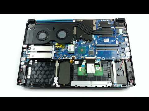

Can somebody show me which point i should put pressure on to take the cover off cause i need to upgrade my ram and the thing is solid and i don't want to apply too much pressure as I sacred it will break.

    Look at this video it might help, it doesn`t show how to remove the cover but basically when you release the clips on the front side (opposite from the exhaust side) push a little on the back side (exhaust side and it will open)

    Look at the video and you will see it - small plastic bumps on the inner side of the shell.

    First: How to : The pressure points are around the corners on the NON-ventilation side. Orientate the laptop on a table (preferably on a non-scratch and non-slip surface) like this picture:
    Get two proper plastic flat tools for opening laptops/ thin plectrum, insert first into the sides at the red arrows and pry and LIFT carefully, if that does not help, insert tools at the top arrows. When the lid pops, you can lift the lid until the fan vents separate from the bottom nearest you. Don't worry - it seems like the plastic vents will break but they do not. Just lift carefully and slowly.
    Another tip: If you insert your tools too deep close to USB/ other ports, it will leave permanent dents. Be very careful there.
