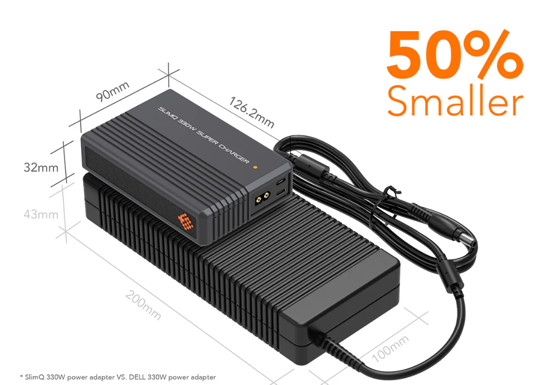

    The best replacement USB-C charger that you can buy and its much better than the oem Acer barrel adapter of the Nitro V15 is the SlimQ 330W DC+USB C Charger that is a Max 330W 20V⎓16.5A GaN Tech type charger and will more than power your Nitro V15 gaming laptop and is the best that there is on the market.
    So buy this adapter as you will be able to enable the performance mode with this adapter. Btw, I use this with my PHN16-71 Predator Helios Neo gaming laptop and it works 100% with my laptop. Good luck and hope this helps you out.
