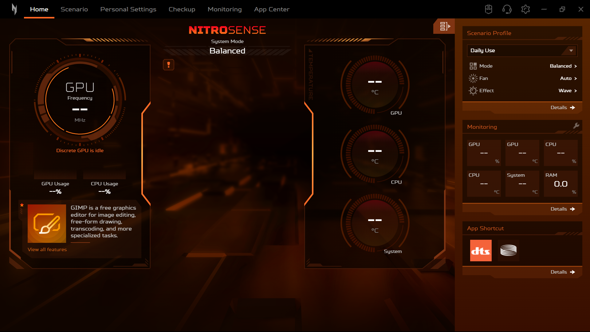

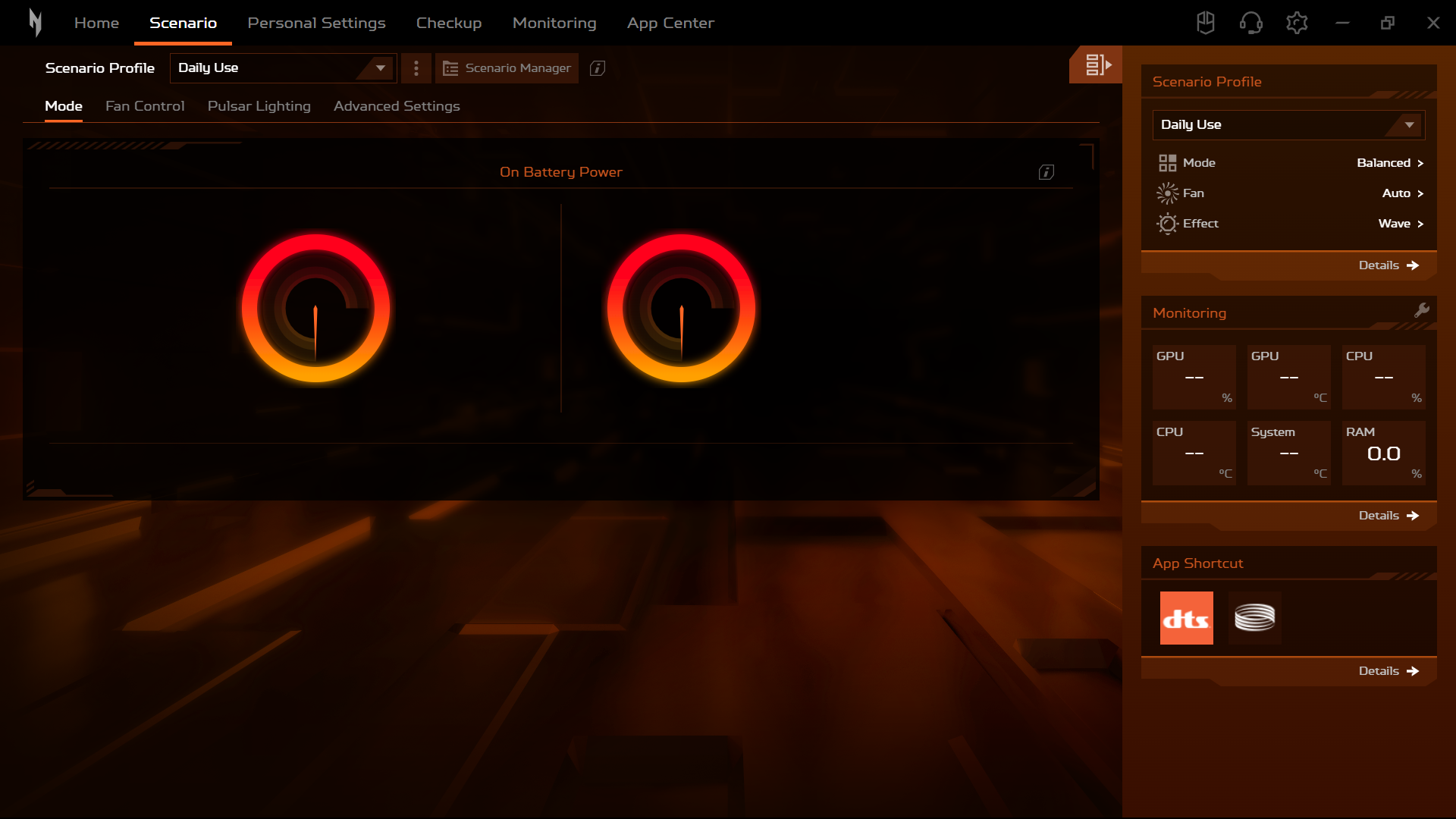

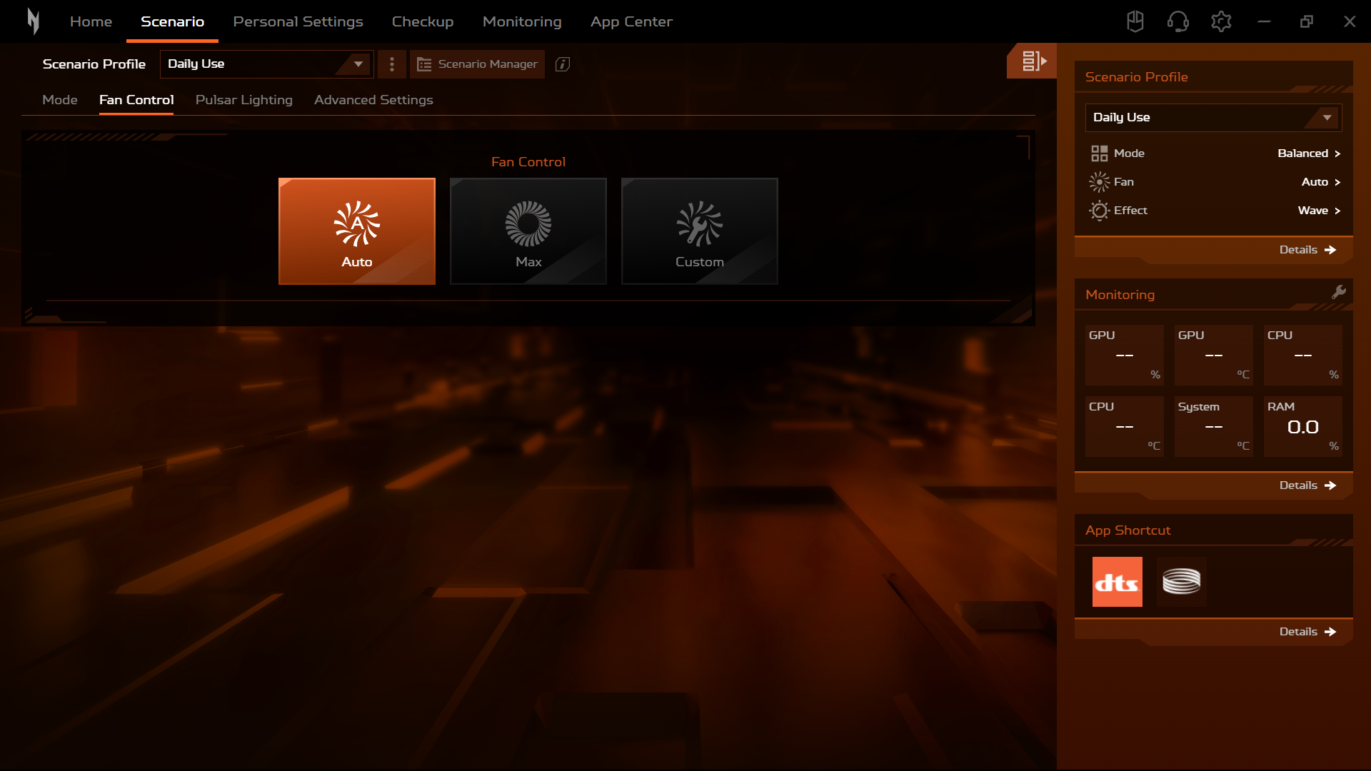

What's this all of a sudden nitosense blank? First GPU fan was not working and now nitrosense?
tarahman
tarahman Member Posts: 9
Tinkerer
edited 9:17AM in Nitro Gaming
What to do now? First GPU fan was not working and now nitrosense.. why ?
  • Puraw
    Puraw ACE, Member Posts: 18,755 Trailblazer
    Hi tarahman,
    You are running on Battery Power only so NitroSense reverts to basic mode to conserve battery backup. Plug in the Power Adapter that came with the laptop (not a USB-C charger) and let the battery charge to 100%, reboot and you will find that NitroSense will work again. Tip: keept he power adapter pluggged in 24/7 and the battery fully charged all time.

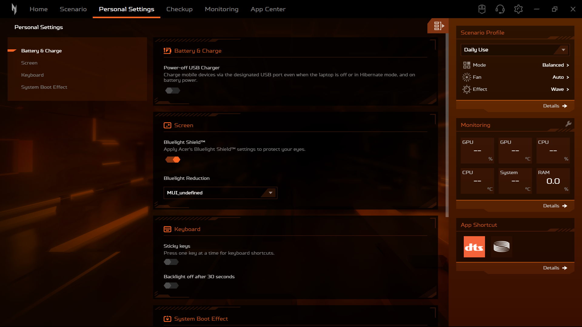

    I am not able to switch back to 100% charging mode. I tried to reset BIOS settings to the defaults.
  • Puraw
    Hi tarahman,
    Just to clarify—when I say “charge to 100%,” I mean fully, not capped at 80%. If your system has a battery limiter enabled (like Acer Care Center’s Battery Charge Limit), make sure that’s turned off first.
    If the battery still won’t charge to 100%, try the following steps:
    1. Update the BIOS to the latest version from Acer’s support site.
    2. Uninstall both battery drivers under Device Manager > Batteries (usually “Microsoft AC Adapter” and “Microsoft ACPI-Compliant Control Method Battery”), then reboot.
    3. Disable Fast Startup via Control Panel > Power Options > Choose what the power buttons do > Change settings that are currently unavailable.
    4. Plug in the original power adapter and leave it charging while powered off or idle. Check if it reaches 100%.
    If it still won’t charge fully, it could be a firmware (EC) issue or a degraded battery, paste this in the command prompt: powercfg /batteryreport and open the report with your Edge browser, press Ctrl + P or right click and select "Print to Microsoft PDF", attach the report to your reply, type @Puraw or use "Quote" when you reply so I will get an alert.
