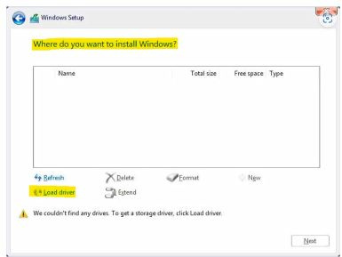

    Make sure that the bios settings of your AN515-58 laptop is set to its "Load Setup Defaults" then construct a proper workable bootable USB with Rufus 4.9 and follow its exact guide and put the Win-11 24H2 .ISO file with Rufus onto the bootable USB first, then put the Nitro 5 AN515-58 Acer provided IRST version: 19.5.0.1037 folder into that same USB, then start the Win-11 installation process by putting this USB into the AN515-58 laptops USB port and reboot the laptop,
    When you get to the Win-11 24H2 section below at > Load driver install the IRST VMD Controller 09AB so that the installation recognizes the AN515-58 M.2 SSD boot drive and you can continue and finish the installation of Win-11 24H2 and all its updated to the last OS build: 26100.4946. Try this method as this should install Win-11 perfectly without needing drivers to be installed. Try this method and let us know. Good luck and hope this helps you out.
    Note: that Win-11 24H2 has an installation bug that it does not connect to the internet to download drivers when its required for the Win-11 24H2 installation and you need to do the below.
    For Acer laptops, press the shift + Fn + F10“ to get command prompt up when are stuck and you need to install drivers during the Win-11 installation > then press next “ windows key + E “ to bring the windows explorer folder from the USB where the drive are.
    Win-11 24H2 version section where you need to put the IRST driver at "Load driver"

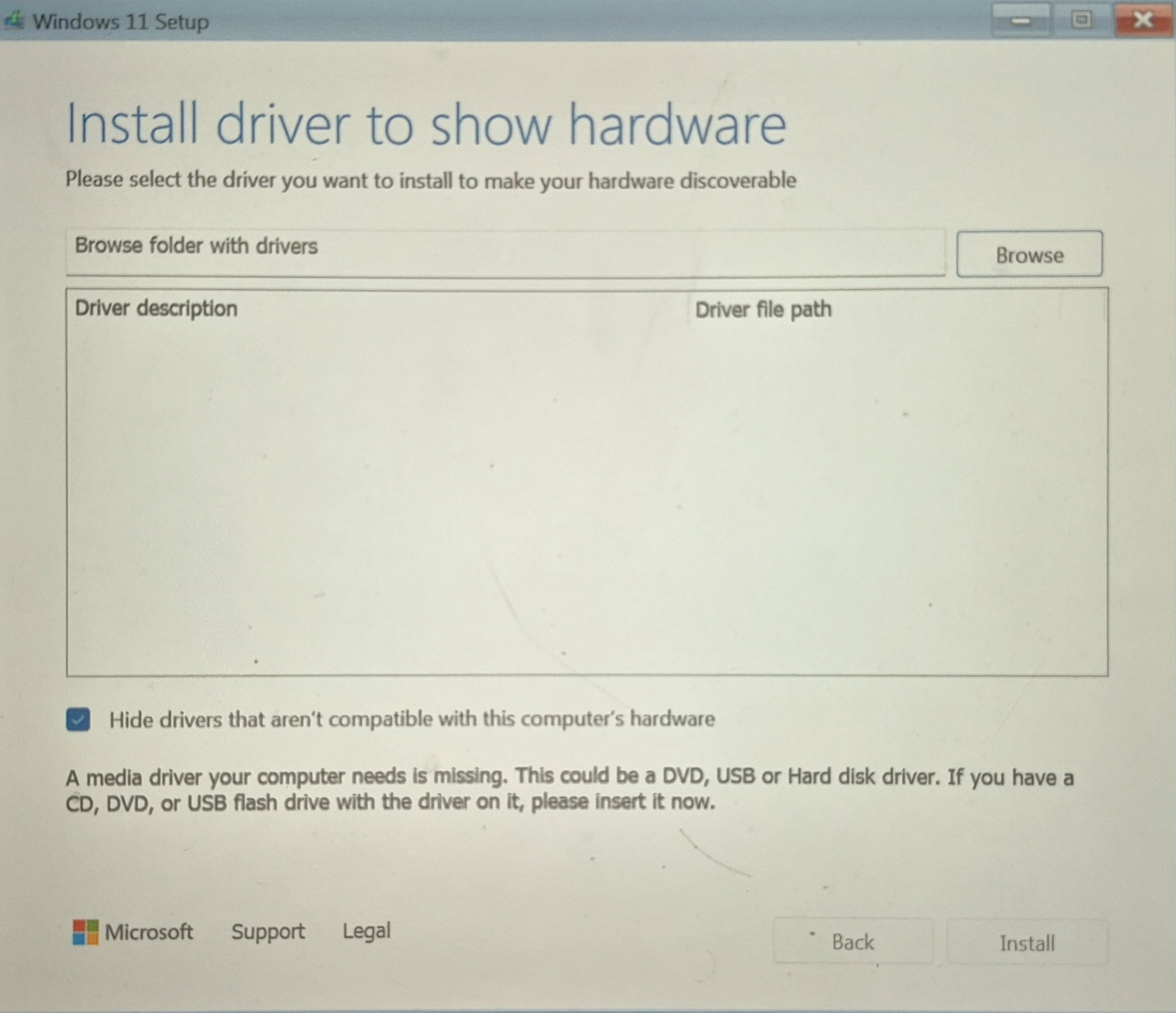

    Hello, while I appreciate the help, this did not work, my issue isn't that I can't see my Partitions at the "Where do you want to install Windows" screen, my problem is that I am unable to get to that section entirely, at boot I instantly get the below screen.

    This is common with a dual boot windows/Linux setup that the Linux settings corrupts the bios and things like these happen, I suggest that the best course is to first uninstall Linux OS and then do a fresh clean install of the Win-11 24H2 installation like above and then install Linux as a dual boot.
    Try to install the IRST version: 19.5.0.1037 drive at the above part of "Install driver to show hardware" it should work, if not try the below steps and see if it fixes this driver Install driver issue.
    The “Install driver to show hardware” error during Windows 11 installation typically happens because the installation media cannot detect the storage drives—often due to missing or incompatible drivers or issues with the bootable USB itself.
    If you continue to encounter issues, it may be helpful to recreate the installation USB using a different computer or with a different software tool, and double-check your BIOS settings to ensure maximum compatibility for installing Windows 11.
