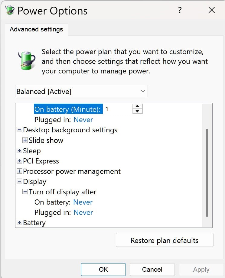

    4. Set Sleep and Display settings to “Never”
      • Refer to the attached Power Options screenshot showing:
        • Turn off display after → Never
        • Put the computer to sleep → Never
    This workaround prevents sleep-related crashes while plugged in. If issue persists, next steps would include EC/BIOS update and clean RZ616 driver install.
