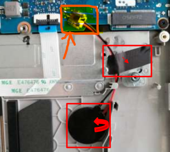

My swift 1, sf114-34-P1DX won't turn on or off, sometimes the acer logo appears briefly then the screen goes black, the keyboard lights flash on for about 10 seconds then off for a second repeatedly.

    Those symptoms are from an EC chip that is either freezing and disabling the laptop from booting or its a main power rail problem. I suggest as a first step try and do a hard reset and see if that unfreezes and properly resets this chip, as it could be that this chip needs replacing and reprograming or your SF114-34 laptop has other main power rail issues that need pinpointing by a technician.

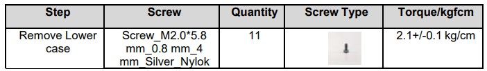

    Do a hard reset of your SF114-34 this way - Use the type of TORX screwdriver spec below to remove the 11 screws that hold the lower case.
    Use a pick to pry the upper edge of lowercase open, then remove the lowercase. Then disconnect the main battery from the mainboard, then take the main battery out. Press the power key for 15 seconds to release all power to the laptop, then disconnect the RTC/BIOS battery plug from the mainboard and then short the bios batteries + & - pins plug at the mainboard (as shown by arrow below) to reset CMOS.
    Leave the laptop like that for at least 30-60min so that the EC chip reset completely and then reconnect everything, as the laptop should turn on and boot properly.
