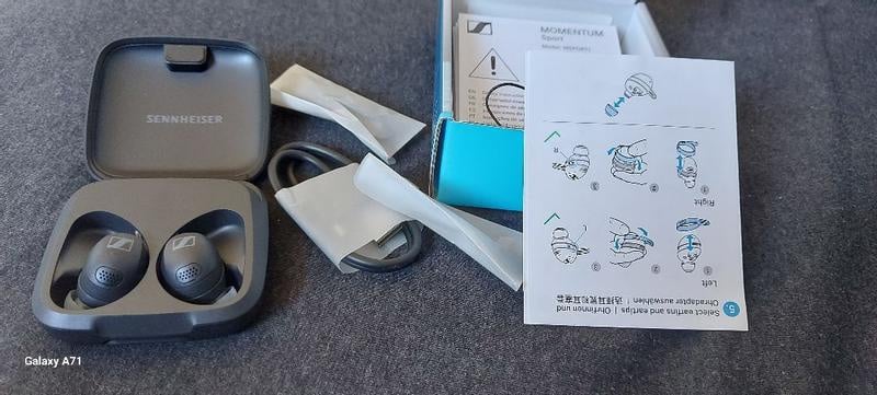

    Just as an example a virtually the same laptop the PHN16-71-50JG model la[top, and I'm using a set of Sennheiser Momentum Sports Bluetooth earbuds with a mic and these earbuds mic work perfectly connected to my Galaxy S24 through Phone Link for calls within my PHN16-71-50JG laptop, as this all depends on which brand of earbud phones that you use as the JBLs should work with the audio out port or USB-C port of the PHN16-71 laptop, if they don't then you can't do anything about, as its a compatibility issue.
    I've also got a set of Sennheiser Momentum 4 with a mic and its a noise cancelling over the ear headset type that you can connect either by Bluetooth or through an audio cable to the laptop audio port and its mic works perfectly also with my phone and through Phone Link with the PHN16-71 laptop either in BT or audio port connection.
    Sennheiser Momentum Sport Earbuds
