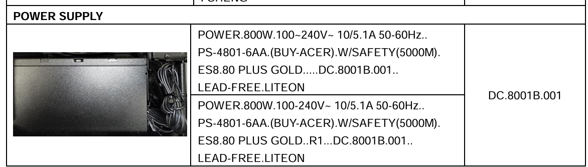

    Your Acer PO7-640 model desktop has a mobo with a 24 pin standard oem PSU plug, so you can upgrade the PSU to the modern wattage modular PSUs that are on the market today that have the 24 pin ATX_POWER plug, as long as these PSU sizes fit into the case and the GPUs also fit into the mainboards 2x PCIE16Х spaces, so make sure that all this can be done to the PO7-640s case and there is enough space, if you don't want to upgrade the oem case.
    If you want to use both PCIE16Х slots with 2x gpu's then of course you need to upgrade the PSUs so that both RTX GPUs will have enough power for the system and the additional GPU, as its listed below.
    These PSUs is what Acer fitted oem into the PO7-640 desktop which are both an 800W powered PSU.
    If you want to fit lets say 2x MSI GeForce RTX 5090 32G SUPRIM SOC @ USD $2879.99 into your PO7=640s desktops into its 2x PCIE16Х slots (if they will fit) then you will first need allot of money😁(like USD $5.8k plus) then you will need to fist calculate the min PSU wattage power that the system and the RTX5090 requires which is a min 1000W PSU + for the 2nd RTX5090 an addition of 575W power which is a min total of 1575W PSU power that your desktop will require.
    Just as a guide, I suggest that you consider using one of the most premium and most powerful PSUs like the Corsair AX1600i model which aint cheap, as its about USD $525.00, as this would be the most suitable PSU that the 2x RTX5090 cards that you want to upgrade to requires, so follow the guide for the exact RTX gpu's that you want to upgrade to below or follow the NVidia links to figure out other RTX power requirements. Good luck and hope this helps you out.
    1. RTX5090 = for the total system it requires 1000W min PSU (GPU only 575W)
    2. RTX4090 = for the total system it requires 850W min PSU (GPU only 450W)
    3. RTX4080 = with the total system it requires 750W min PSU (GPU only 320W)
