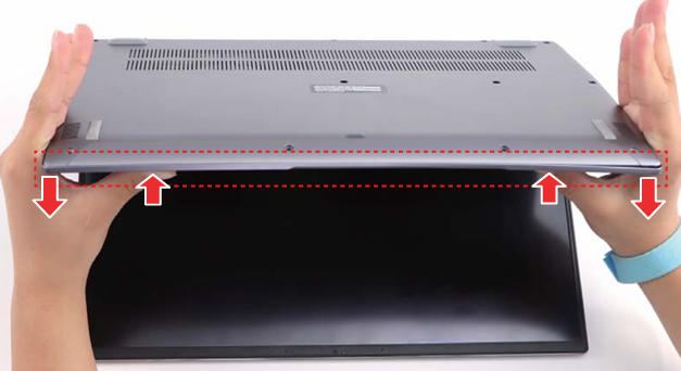

    You need to do a Hard Reset first of your laptop, as the EC chip on your SFX16-xx laptop is stuck and frozen and needs a proper reset, so follow the guide below. If a hard reset doesn't fix the laptop boot, then you need to do a Win-11 stirrup repair, to fix the start-up files, if that doesn't work, then you need to reinstall Win-11 with a clean install, if that docent work, then the boot M.2 SSD is faulty and you need to replace the drive. Good luck and hope this helps you out to fix the laptop booting.
    Hared Reset: Remove the twelve (12) screws securing the lower case to the upper case, place both thumbs on the centre of the upper case then push the upper case firmly to pry the bottom edge latches, then continue releasing the remaining latches. Then remove the lower case.
    Then disconnect the main battery cable from the mainboard, then take the main battery out. then press the power key for 10 seconds to release all power to the laptop. Then disconnect the RTC/BIOS battery and then short the bios batteries + & - pins at the mainboard plug (as shown below in the orange squared area) to reset CMOS.
    Leave the laptop like that for at least 30-60min so that the EC and Chipset chips reset completely and then reconnect everything and reboot, as the laptop should turn on and boot properly with an image on the screen and not get stuck on the "acer logo".
