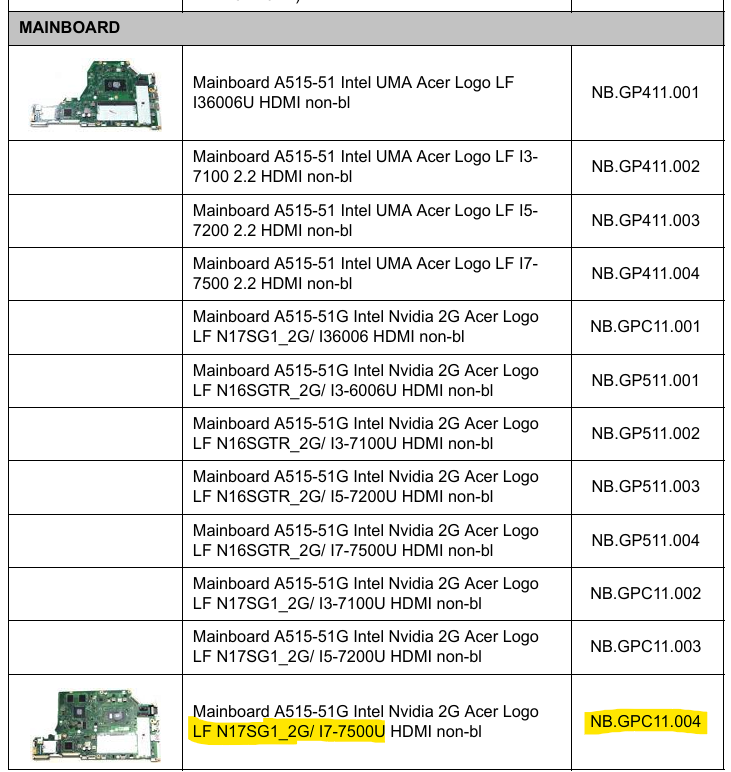

    I don't know what is the exact specifications of your Aspire A515-51G laptop, but below are all mainboards that Acer fitted to this laptop and its top spec boards. I suggest that if you buy a new mainboard, you upgrade to the top spec A515-51G board Acer part#: NB.GPC11.004 which there is one for sale on eBay for US $242.28 + FREE shipping with the i7-7500U cpu and the NVidia MX150 2GB gpu, that I've highlighted below from the Aspire A515-51GT laptop. Good luck and hope this helpas you out.
