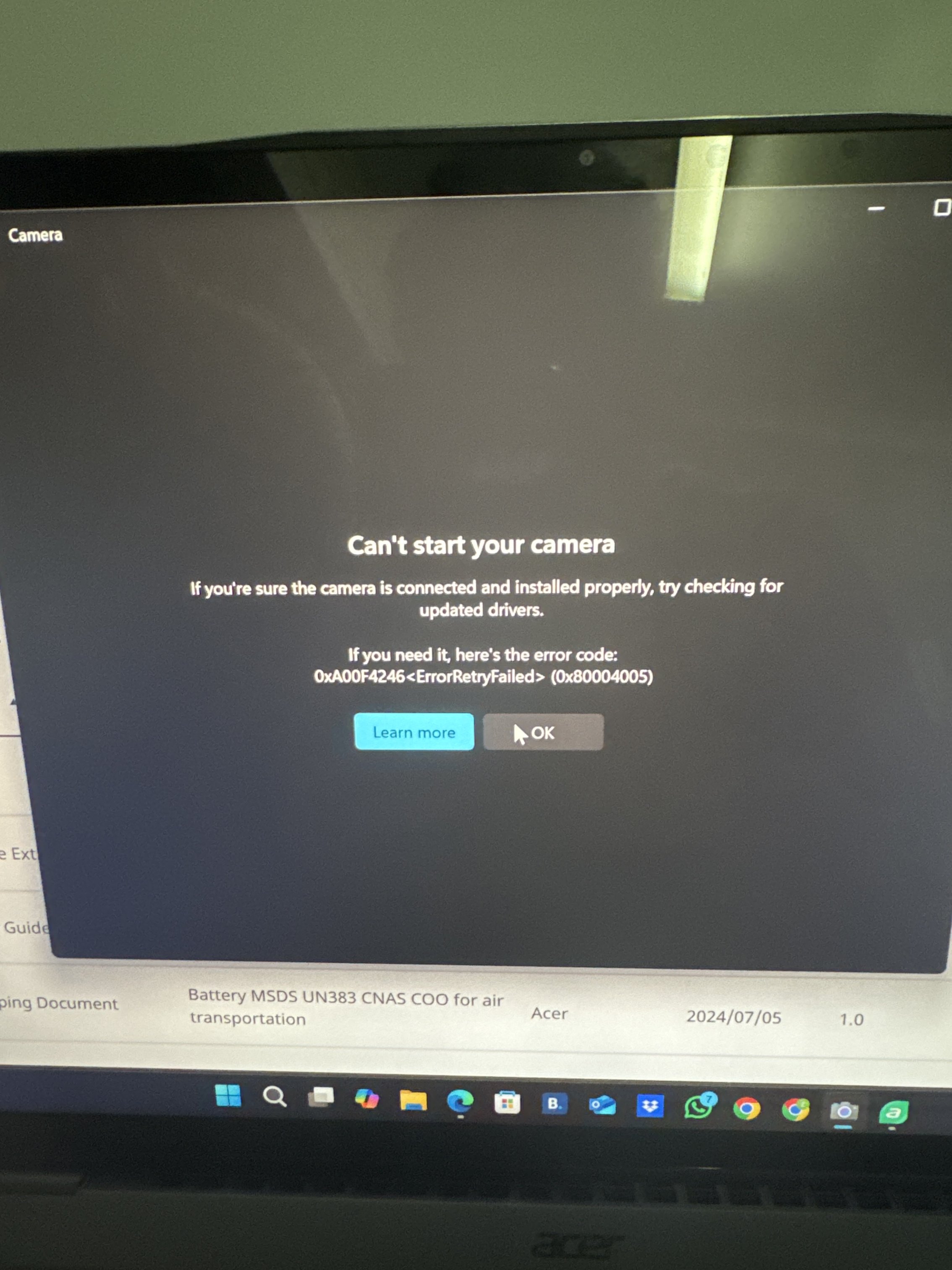

Camera is showing error 0xA00F4246<ErrorRetryFailed> in Swift 14 Ai
Zainwains
Zainwains Member Posts: 3 New User
edited 4:44AM in Swift and Spin Series
1 day ago I reset my laptop Acer Swift 14 Ai snapdragon and after that camera stopped working it’s not working on anywhere not on teams camera app, WhatsApp

    Hi @Zainwains
    On Snapdragon‑based Swift models, this camera error can usually be fixed without manual driver installs:
    • Option 1 – Quick reset:
      1. Open Device Manager → expand Cameras.
      2. Right‑click the Snapdragon camera → choose Uninstall device.
      3. Restart the laptop — Windows will auto‑reinstall the working component.
    • Option 2 – In‑place recovery via Windows Update: This repairs system components without deleting your files.Follow Microsoft’s step‑by‑step guide (see link below): Fix issues by reinstalling the current version of Windows.
    Avoid manually installing camera drivers — the default Windows‑supplied package is the one tested to work on this platform.
    https://support.microsoft.com/en-us/windows/fix-issues-by-reinstalling-the-current-version-of-windows-497ac6da-7cac-4641-82a5-f50398d879a0
    I did this thing but still showing same issue

    Puraw ACE, Member Posts: 18,449 Trailblazer
    mportant clarification on recovery methods:
    The In-place Recovery via Windows Update is not the same as the older “Reset this PC” option.
    • Reset this PC often reinstalls Windows from a local image and may remove apps or drivers.
    • In-place Recovery uses the latest Windows Update files to repair system components without deleting your files or apps. It’s a non-destructive reinstall that preserves your setup while fixing broken modules—like the camera stack on Snapdragon models.
    Please confirm: did you follow the exact steps from Microsoft’s guide here?🔗 Fix issues by reinstalling the current version of Windows
    If not, I recommend trying that method before any manual driver installs. It’s the most reliable fix for this platform.
    I did the following steps as described in the website but nothing worked
