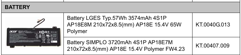

    Do a proper Hard Reset (see methos below) and see if that fires your laptop up, if it doesn't, then the battery is locked up, as and if you haven't changed the battery in your laptop in 3-4 years, the old AN515-57 battery completely discharges and locks up, so what happens is this, as the battery is old, it locks up and needs a special battery tool to unlock it and recharge it fully, as you never ever allow old batteries in these laptops to discharge below 10-15% as they will lock up and will need a special tool to unlock them. But after 3-4 years its best to replace the battery anyway.
    The only choice you have is to either take the laptop to a technician that has a tool called an "NLBA1 PRO Laptop Battery Analyzer Tester Repair Charger" (which aint cheap) which not many techs have or buy a new battery for your AN515-57. If a new battery doesn't fix the laptop booting and firing up, then you have a problem within the EC, BQ chips that govern the charging phase of your laptop and they need replacing and you need to take your laptop to a technician to be repaired. Good luck and hope this helps you out.
    Acer oem batteries for the AN515-57
