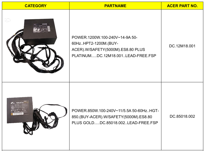

    I don't know which PSU your PO5-650 came oem from Acer with, if its the 1200W or the 850W, but if you need to replace the PSU, here are the two PSUs that acer used for the PO5-650 desktop model, if you want to replace yours and your PSU is doggy. But I would upgrade to a good modular PSU like the Corsair HX1200W Modular PSU.
