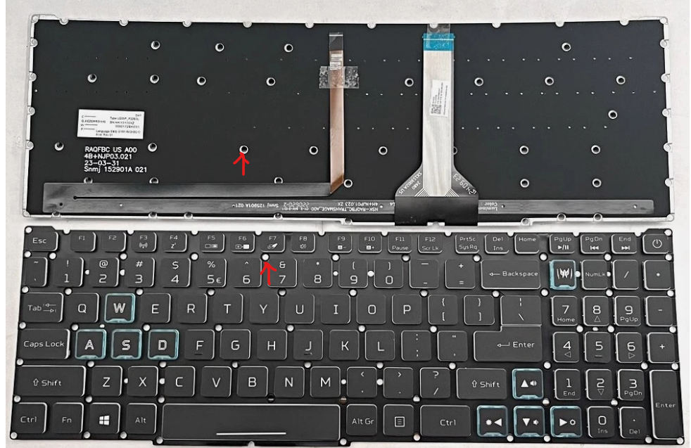

    Below is a caption of the PHN16-72 RGB keyboard available on eBay and as I've outlined with red arrows, those holes are for the rivets that need to be unriveted and then riveted back. so that the keyboard can be attached to the upper case. This is a big job and you could damage the upper case as allot of tech have done and attempted to do this replacement to other laptops. I suggest that its allot easier and better to replace the whole uppser case and keyboard as a combination than just replacing the keyboard.

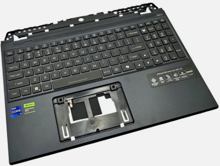

    Below is an original Acer oem Upper Case/Keyboard US International language Acer part #: 6B.QNNN2.001 that is for sale on eBay for USD $318.98 which aint cheap, as I can't find any other places that sell these parts, not even the specialist Acer parts retailers like ZANDPARTS.
