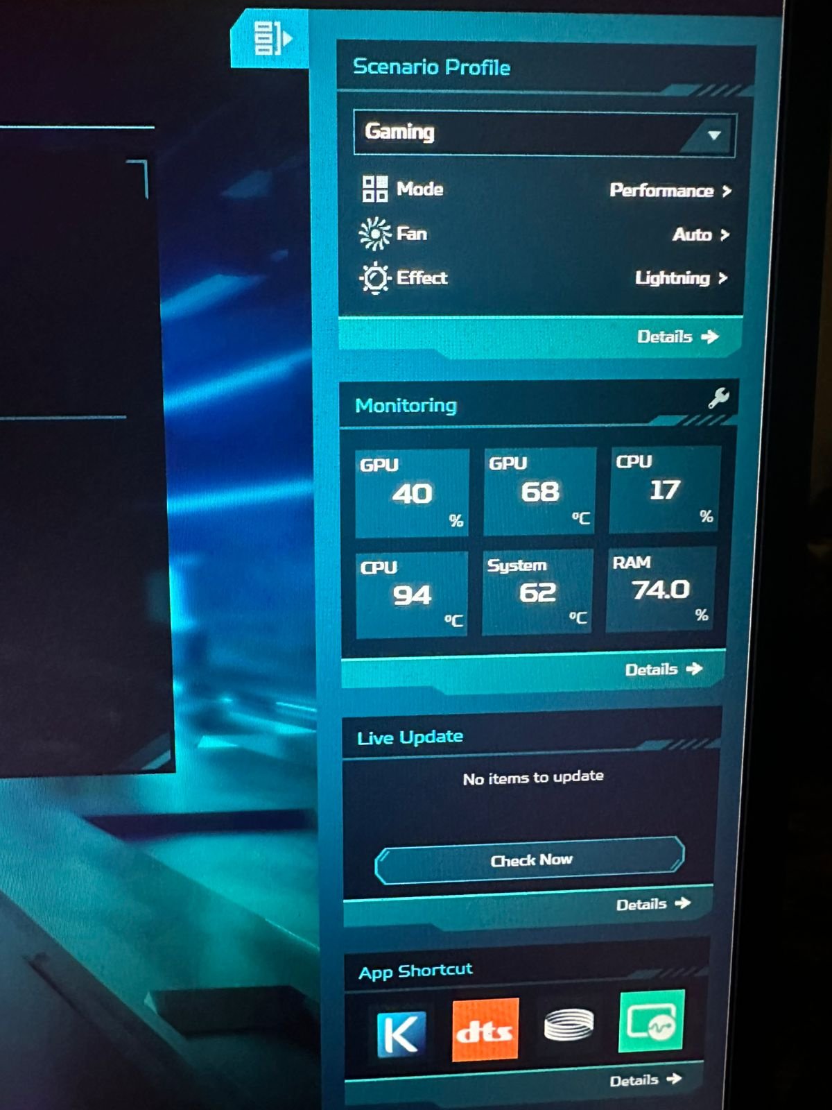

The CPU is reaching 95 with very light gaming.
3 months ago, I was playing the same game with CPU temp 70.
I took my laptop to ACER service center, but they could not find the problem. We change the thermal base with no benefit. The fan seemed to be working fine when they checked it, but that was game off.
My question is: because the usage of CPU is very low, but the CPU overheated, and at the same time GPU is fine, that means most likely the problem is in the fan itself, not in the heatsink, otherwise the GPU is supposed to be overheated to right?
My laptop is "Predator PH16-71". I bought it a year ago

    Hey @Hamad _511 — thanks for sharing your setup. That 95°C spike during light gaming is definitely unusual, especially with low CPU usage and normal GPU temps. It’s likely a combination of aggressive CPU boosting and ambient heat buildup, possibly worsened by a high-performance SSD in the second M.2 slot.
    Here’s a full set of steps to help diagnose and reduce temps:

    🔧 Power Plan & PredatorSense Tweaks
    • Use the Balanced Power Plan in Windows.
    • In PredatorSense, switch to Best Power Efficiency mode.
    • This combo has helped other PH16-71 users drop temps from 95°C to 70–80°C during gaming.

    Even if the SSD isn’t directly heating the CPU, excess heat in the chassis can raise ambient temps and cause the CPU to boost harder to compensate—especially if boost mode is still enabled.
    Let us know what SSD model you’re using and what temps you’re seeing after these tweaks. We can help confirm layout, padding, and firmware options if needed!
