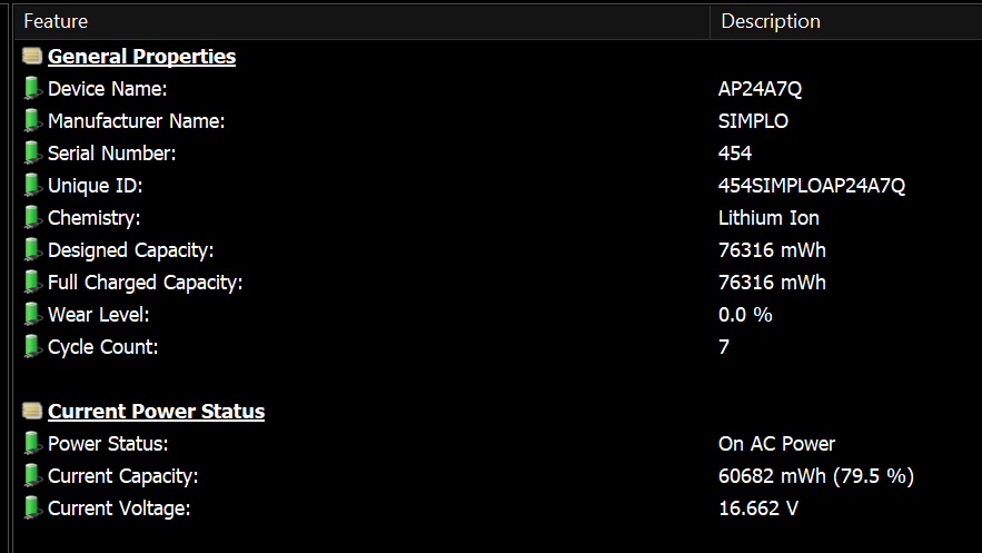

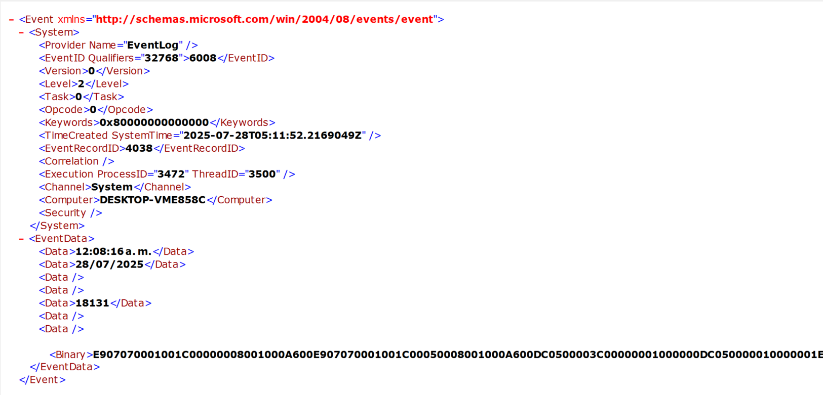

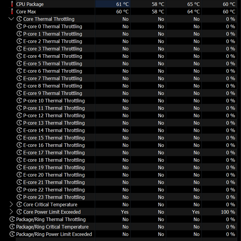

  • Checking battery health using HWMonitor (see attached screenshots)

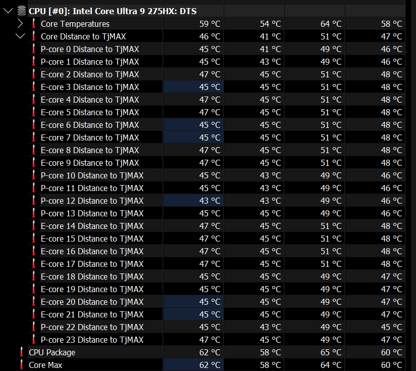

  • Monitoring temperatures (they stay between 80–95°C, which is reportedly normal for this laptop model)
  • Reviewing the Event Viewer logs (notably Event ID 6008, but the logs are inconclusive)

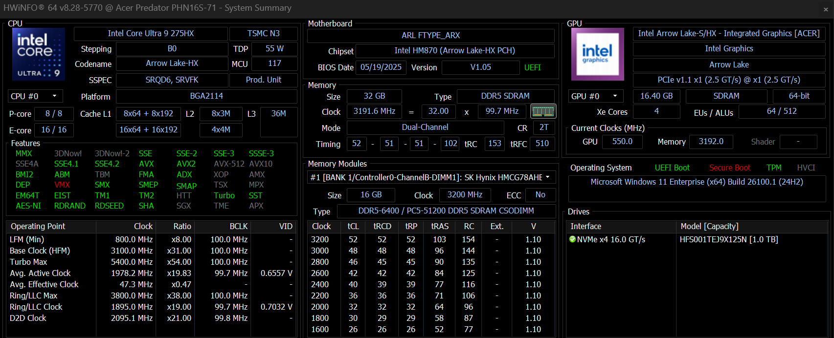

  • Updated Bios version to 1.05

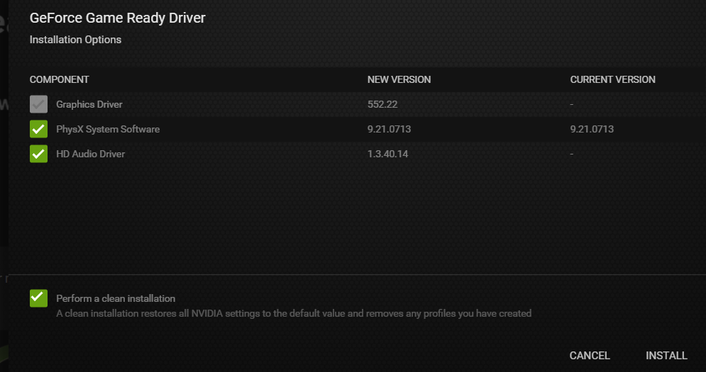

    Then, install the NVidia App and play all the supported games through the NVidia app and also download the latest NVidia Game Ready drivers through this app, and when you install new drivers, always install and "Perform a clean installation" like shown in the caption below, as that deletes all previous traces of the old NVidia drivers. Also make sure that you have all the Win-11 version 24H2 and all the updates up to the last OS build: 26100.4770 installed. Try all that and let us know if the gaming improves on this new PHN16DS-71 AI Neo, good luck and hope this helps you out.

    3. Battery Reading Shows Zero Wear? That’s suspicious. Could be:
      • Firmware misread due to early BIOS quirks
      • Battery telemetry bug
      • Or simply too few charge cycles logged so far If you're using HWMonitor, consider cross-checking with the built-in Windows battery report (powercfg /batteryreport via CMD).
    🧩 Important Diagnostic Step Often Missed:
    After a crash, don’t rely only on Event Viewer—check Reliability History using perfmon /rel. The graph may look clean, but that doesn’t mean all is well.
    📋 To dig deeper:
    • Click View all problem reports
    • Look for entries like Kernel-Power, LiveKernelEvent, or WHEA-Logger
    • Copy the technical details to Clipboard, paste into Notepad, and save as .txt
    • Upload those .txt files here for deeper analysis—great way to spot firmware or driver faults hiding under the radar

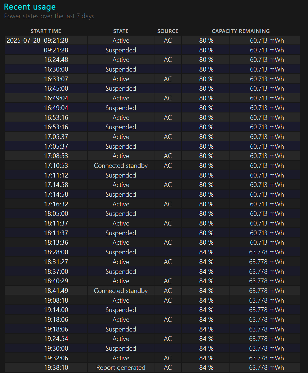

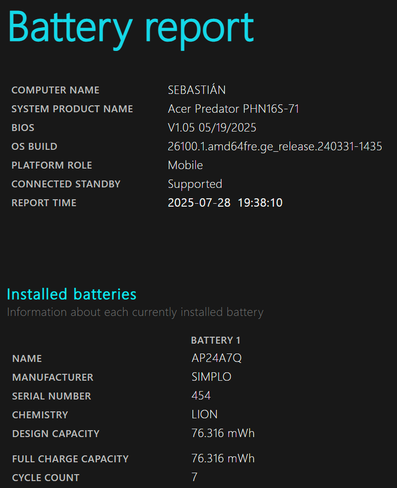

    Thank you for all your recommendations. I’ve just performed a fresh clean installation of Windows with the latest updates to make sure there are no corrupted files. So far, I’ve only recorded 7 charge cycles, so the battery likely has minimal wear. I’ve attached the Battery Report. I also applied the fixes suggested by StevenGen and will keep you informed if the issue continues. If it does, I’ll send you the .txt files with the technical error details.
    Lastly, I already contacted Acer’s technical support, but the assistance was very poor — just generic solutions I had already tried. They suggested sending the device internationally for inspection, but I really hope it won’t come to that.
    Thank you so much for keeping an eye on the issues affecting our beloved Acer Predators. I’ll keep you updated!
