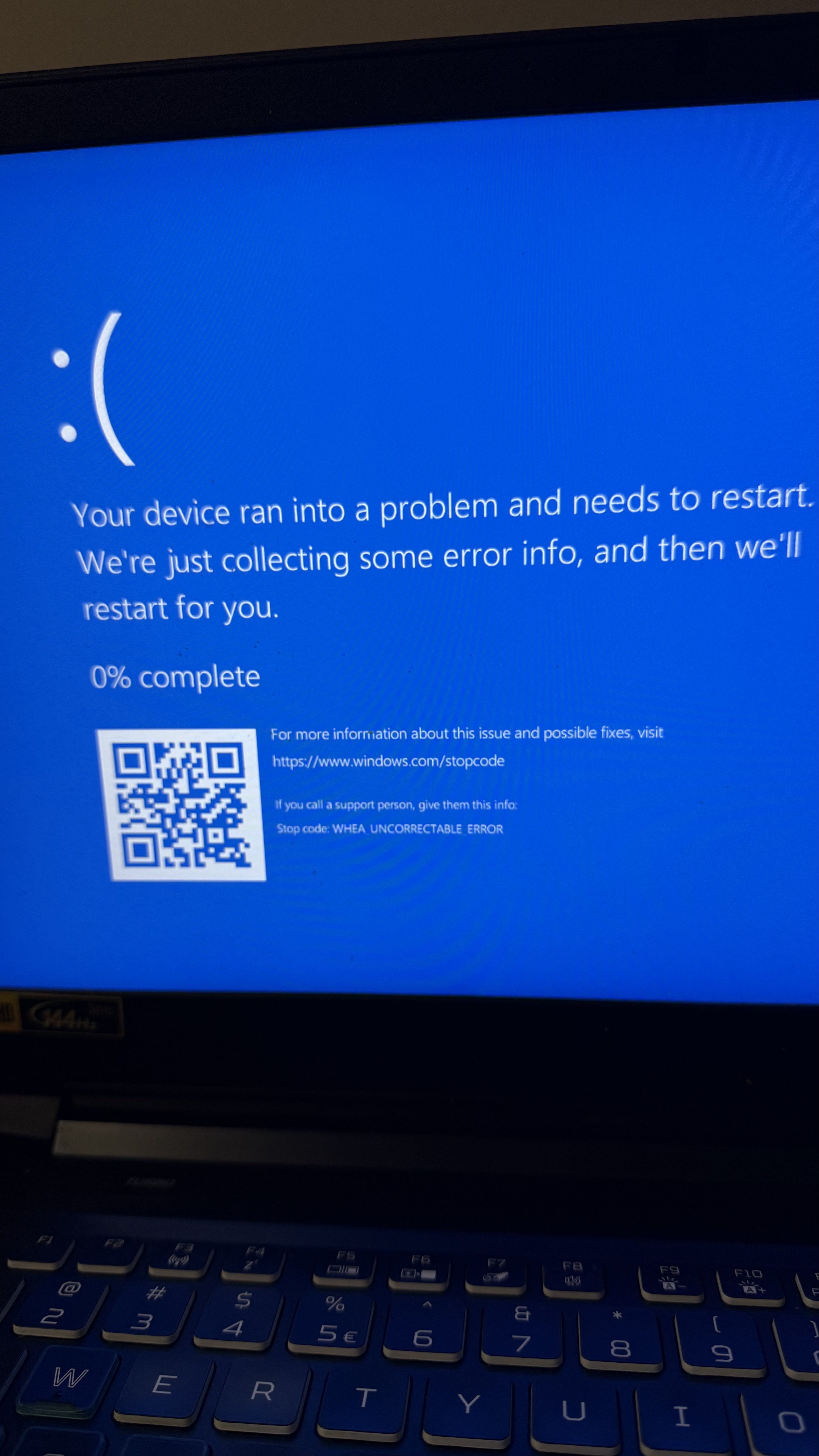

i recently posted here a question about my laptop not turning on, and just keyboard lights are up and running, and its restarting with a single beep.
Based on a response, i started running the laptop with a battery, i removed the battery and tried to turn it on, and it did work, it turned on everything looked perfect. ( but everytime i turn on, it turns on with a very loud predator bootup sound, i never turned it back again since i bought the laptop, so it felt diff)
After using it for 2-3 minutes it shut down, tried restarting, and its up for a minute or two and getting shut down again, showing an error we will be restarting it for you finding problem 0%, yet it never restarted, left it on that screen for a whole night.
I still have not inserted any battery in it, if i do so, it completely stopped turning on, without it, the laptop turns on and works for a minute or two before turning off or going to thr screen which says we will restart it for you.
What are the options i am having right now? What can i do? I will be attaching more pictures here

    StevenGen ACE Posts: 14,968 Trailblazer
    Follow the guide for the BSOD that you are getting for the "How to fix WHEA_UNCORRECTABLE_ERROR" and see if that fixes your issues. If not, take your PH315-55 laptop to a technician as you have a main power rail problem that need a technician to analyse and pinpoint the exact problem and fix it, as you can't fix these sorts of faults by any reset or software reinstallation. Good luck.
