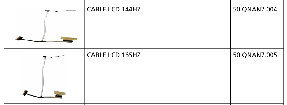

    If that doesn't fix the partial screen freezing it could be the data section of the eDP cable of your laptop and lastly and its very rare that it could be the actual screen that is faulty. So the only thing that you can do is uninstall all the AMD and NVidia drivers with the DDU uninstaller in Safe Mode and then reinstall all these drivers and see if it fixes this fault, otherwise send/take your laptop to Acer Tech Support in your country and get the Acer techs to fix this issue. Good luck.
    The ANV15-41 eDP cable plugs or actual cable could be faulty
