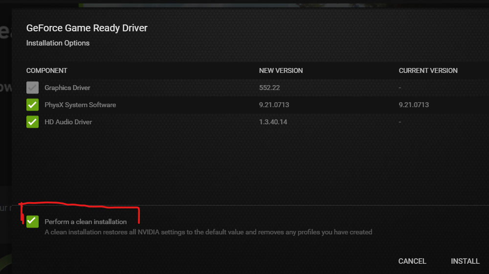

  • StevenGen
    StevenGen ACE Posts: 15,212 Trailblazer
    edited July 27
    Install the NVidia App and update the RTX3070 game ready driver that way with that app and do a clean install when you install the driver, so that all the previous NVidia drivers are deleted off your system. As that is how you should install all Nvidia drivers. if you are still getting BSODs errors then its related to the gpu or the vram hardware that is faulty and its causing those errors.
    Install the NVidia driver with this option only every time.
