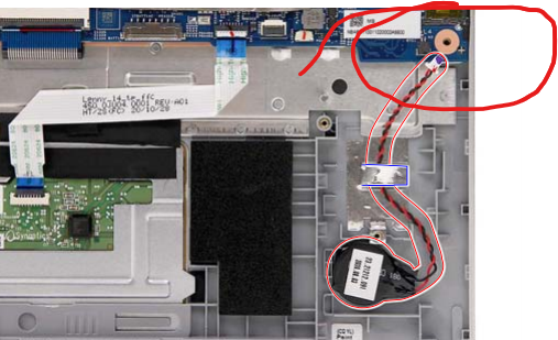

    Hard Reset - Remove the eleven (11) screws from the base cover to the upper case of your Spin SP114-31 laptop, pry the sides of the lower case from the upper case to disengage the latches. Then remove the lower case.
    Press the power key for 15 seconds to release all power to the laptop and then disconnect the main battery cable from the mainboard, then take the main battery out. Then disconnect the RTC/BIOS battery and then short the bios batteries + & - pins at the mainboard plug (as shown at circled area below) to reset CMOS.
    Leave the laptop like that for at least 30min so that EC and Chipset chips reset completely and then reconnect everything, as the laptop should turn on and boot properly with an image on the screen.

    @StevenGen could u breakdown the 3rd paragraph I'm having trouble understanding.

    Yes sure, after you have take the back cover off your laptop and the battery out, press the power key for 15 seconds so that all remaining power that is within the laptops circuitries are released completely and there is no current within the laptop at all, that is what that means. Also wear an anti static wrist band so that your fingers do not insert any static into the laptop, that could damage any circuitries within the laptop also.

    @StevenGen Which part am I to short red or blue?
