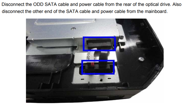

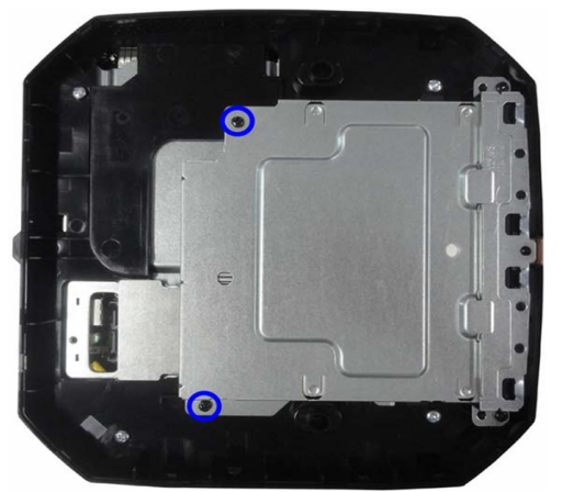

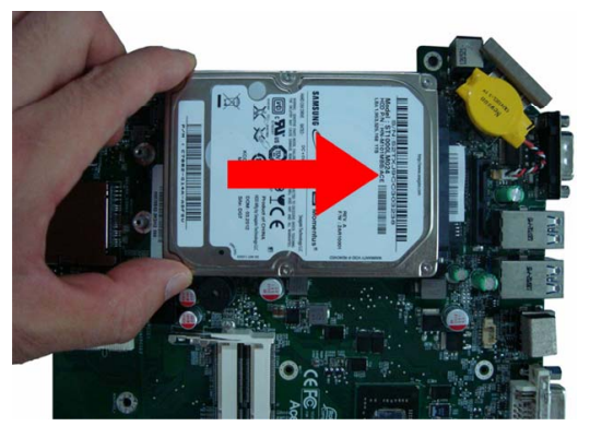

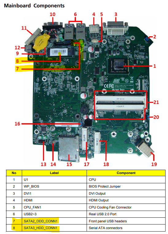

    The Veriton N4620G desktop computer does not have a space for a 2nd HDD its got an ODD CD/DVD drive space which its data/power slot SATA III type and connected with a SATA cable like shown below, the ODD is also secured with a special bracket on the other side of the mainboard, if you want a 2nd HDD, you will need to see if there is a 2.5" caddy for this model to fit where the ODD drive is or use another way of securing a 2nd HDD instead of the ODD drive. Good lucak and hope this helps you out.
    All these components are underneath the desktop unit maked in red below
    SATA III HDD position slot is a data ands power plug

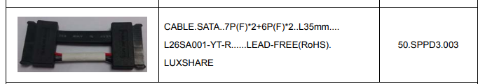

    ODD Drive is a SATA III data/power plug and its connected with the SATA cable below and its position is on the other side of the board to the HDD.
    SATA ODD cable
