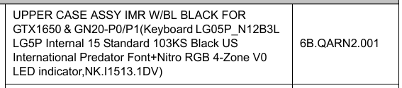

    The symptoms that you are getting is that the power button mechanics are faulty and worn out and needs replacing, you can get new parts for these keys, try HERE as this is just one place you can get these parts. or buy a new keyboard if you want for your AN517054 model which if your language is US International its the keyboard below. Good luck and hope this helps you out some more.
