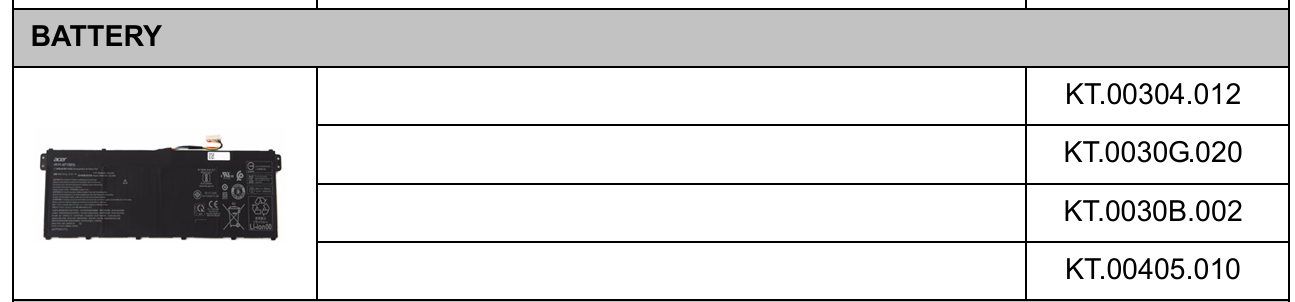

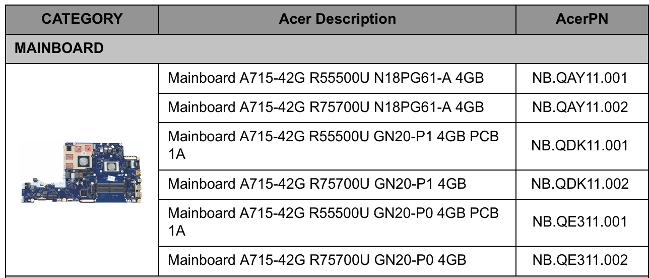

    Your Acer Aspire A715-42G is a 2021 released Acer mid range type of a laptop, its NOT a full on gaming laptop, if you haven't changed the main battery yet, then I suggest that you do that asap as that contributes to normal and especially gaming performance drops and could affect the cpu's performance, like you are experiencing. If and after you replace the battery, and you still get this cpu throttling and 400mhz issue, then its the actual cpu that is faulty which can't be fixed and you will have to make do with want you have.
    Remember that its economically unviable to replace the cpu in your laptop, as Intel does not sell these cpu's for notebooks new, and there are none available online, as these laptop cpu's or dedicated gpu's can be replaced by a technician if you have the part, but its such a waste that it can't be done due to lack of parts available. Or and if your A715-42Gs cpu give up, then you will need to replace the mainboard with a new board, So good luck and hope it works out for you.
    These are the A715-42G batteries and the mainboards for your reference if you need to replace the mainboard, but make sure you replace the battery.
