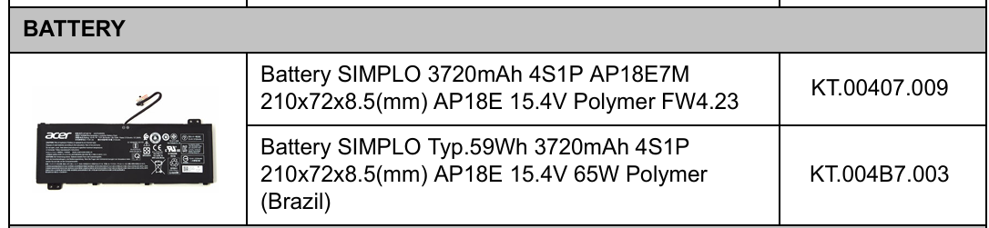

    Be aware that your PH315-53 is a 5 year old released laptop, and if you haven't replaced its main battery then your laptop is due for a new battery, as this also affects performance especially in high end gaming,.
    With the benchmarking with the PassMark 3D tests that you are getting for the PH315-53 with RTX 2070 gpu shown above, if the best test result is 13,300 and its the Pass Mark Rating score, then that is an unbelievable score for your PH315-53 and its a bit hard to believe that its correct?
    As with my 2023 built model Predator Helios Neo PHN16-71-50JG with an i5-13500HX cpu / RTX4050 gpu / 64GB RAM at 2 32GB DDR5-4800MT/s CL40 / 1TB Samsung 990 Pro + Heatsink M.2 SSD which is a pretty high spec laptop, I get a PassMark Rating of 10,050 which is 32% less than your 13,300 PassMark score, which can't be correct, as its impossible that you get those scores with a Predator with a 10th Gen cpu and the RTX2070, also and if you are getting those results above, the tests must be wrong and there is something wrong with the sensors and hence its a good idea to change the battery for a performance boost and to rectify the drop in performance. Good luck and hope this helps you out to solve this problem.
    Here is the oem Acer suggested batteries that your laptop requires and DO NOT buy a cheap copy battery.
