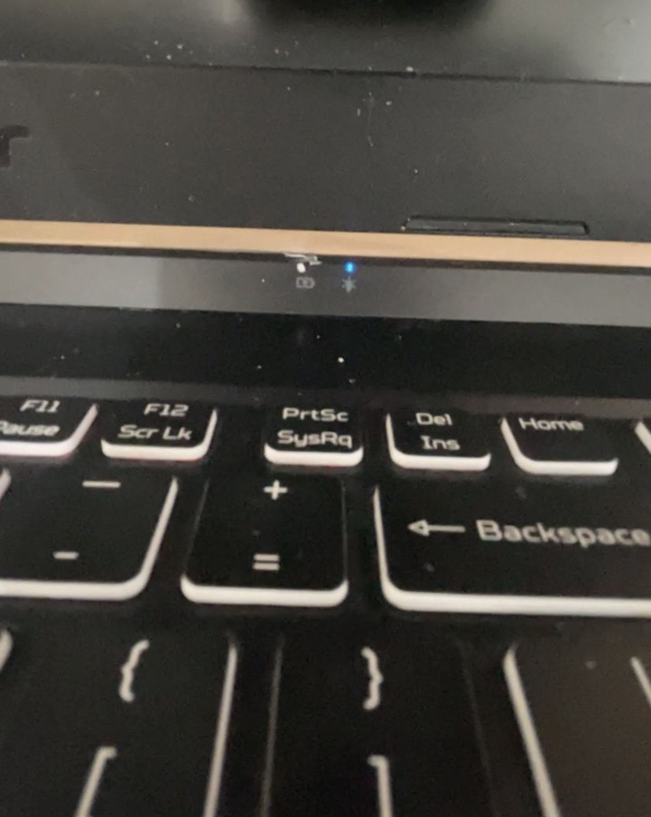

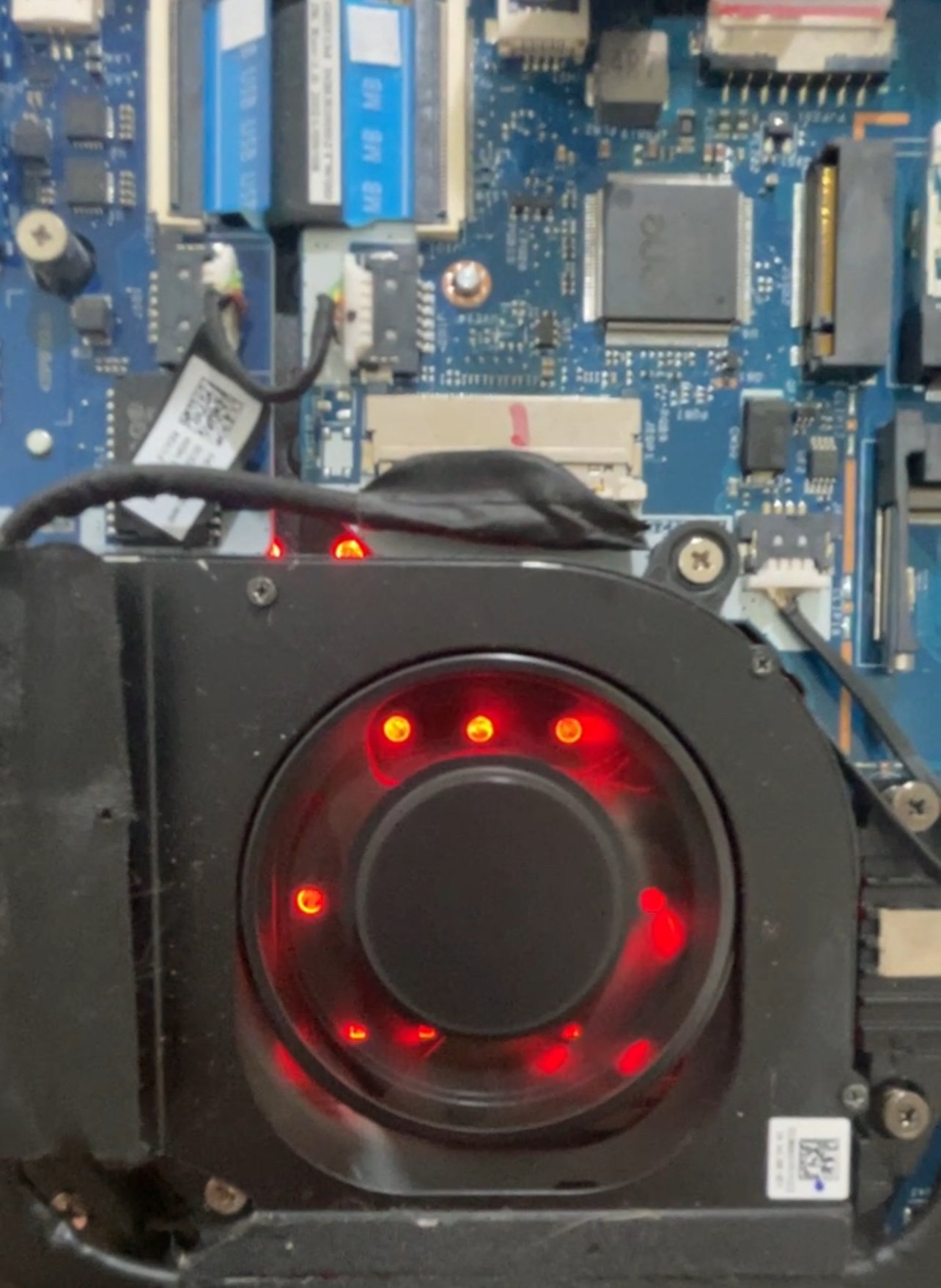

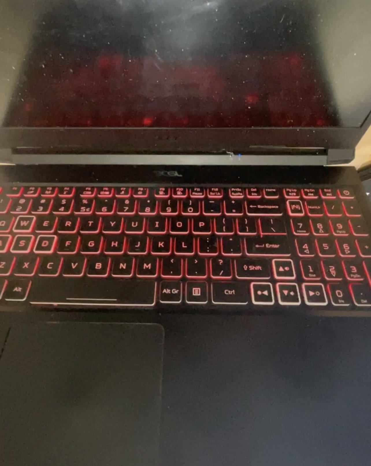

Hoping someone has some words of wisdom.
Powers on for 1 sec, keyboard lights up, blue light comes on, both fans work, then system stops and restarts in another few seconds. I tried to attach a video but it keeps timing out, can someone advise how to do this please and best format as I have an iphone to record. Photos attached for now.
Have done all the usual, power drain, remove RAM, battery, unplugged CMOS (though repair guy I consulted advised never to do that… but I see this mentioned in lots of places) etc etc but nothing changes. Repair guy had a cursory look, did same as I did, nothing more and tells me it is the MB though I not ready to give up on it just yet.
Anyone experienced the same thing or can offer some further information on what I could look for?
