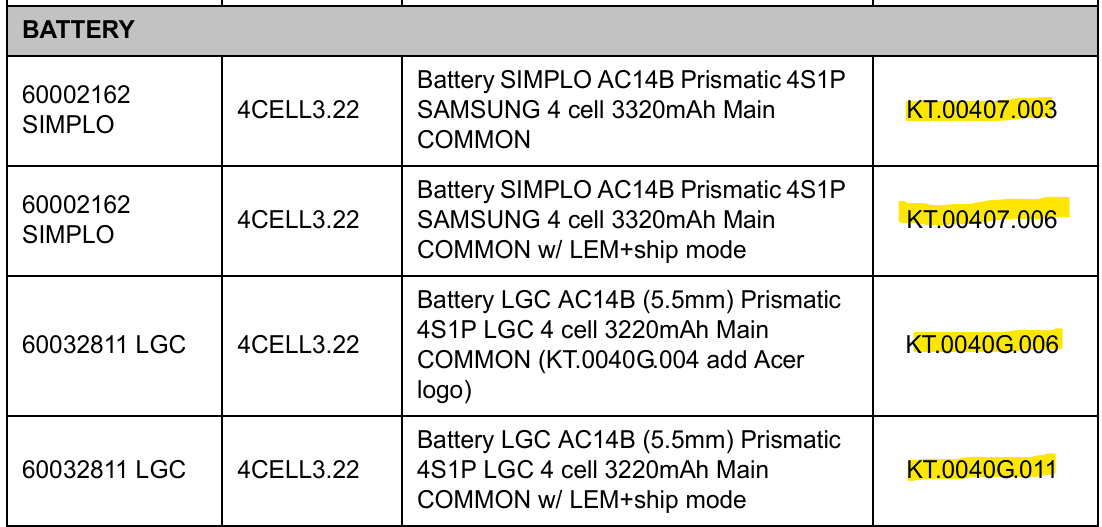

    Did you buy an original Acer oem battery for your AN515-52 laptop, as a cheap copy battery could be giving you a false reading or not reading the laptop battery sensors and that is why the orange lights are flashing, as the laptop does not know that the battery is fully charged. Try to do a Hard Reset also of the laptop as that will reset its CMOS, as the battery and should fix this problem, so that the EC chip will detect the new battery.
    The below list are the Acer fitted original battery part numbers and types fitted to the Nitro AN515-52 model, so only fit these batteries for best results.

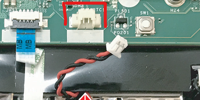

    Hard Reset - remove the HDD and RAM doors and then remove the fifteen (15) screws from the base cover to the upper case of your Nitro AN515-52 laptop, starting from the upper side, pry to release the upper side latches, continue releasing the remaining latches. Then remove the lower case.
    Press the power key for 15 seconds to release all power to the laptop and then disconnect the main battery cable from the mainboard, then take the main battery out. Then disconnect the RTC/BIOS battery and then short the bios batteries + & - pins at the mainboard plug (as shown at the plug below) to reset CMOS and then take all the ran out.
    Leave the laptop like that for at least 30min so that EC and Chipset chips reset completely and then reconnect everything, as afterwards your laptop should detect the new battery,
