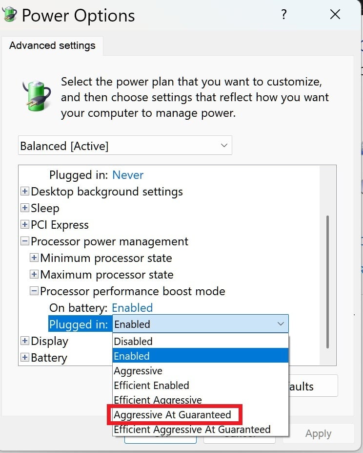

    🛠️ What You Can Do Instead of limiting CPU speed, you can adjust the Processor performance boost mode:
    1. Go to Control Panel > Power Options > Advanced Settings
    2. Expand Processor power management > Processor performance boost mode
    3. For “Plugged in,” select:
      • Efficient Enabled or
      • Disabled (if you want maximum battery protection)
    This reduces aggressive power spikes without sacrificing too much performance. Here's a screenshot showing the setting:
    📷 (You can find this under the Balanced power plan > Advanced settings > Processor power management.)
    Also, in Windows Settings > Power & Battery, choose Best power efficiency mode while gaming on AC.
