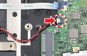

    What is your Swift 3 laptops exact model number, as and if its more than 3-4 years old, you need to change the battery as that is one of the main causes of your laptop turning off and not booting. It can also be a frozen EC or a Chipset chips (if not damaged or faulty) can be fixed with doing a proper Hard Reset, if that doesn't fix your booting problems then its an internal main power rail or graphics issues. Good luck and hope this helps you out.
    Follow the Hard Reset like in the guide below, as in most cases it fixes the boot issue of your Swift 3 laptop. If not then you have issues that only a technician can fix as no reset will do anything.
    Hard Reset - Remove eleven (11) screws from the base cover to the upper case of your Swift 3 laptop, use a pick to pry the upper edge of lowercase, then remove the lowercase.
    Press the power key for 15 seconds to release all power to the laptop and then disconnect the main battery cable from the mainboard, then take the main battery out. Then disconnect the RTC/BIOS battery and then short the bios batteries + & - pins at the mainboard plug (as shown below) to reset CMOS.
    Leave the laptop like that for at least 30min so that EC and Chipset chips reset completely and then reconnect everything, as the laptop should turn on and boot properly with an image on the screen.
