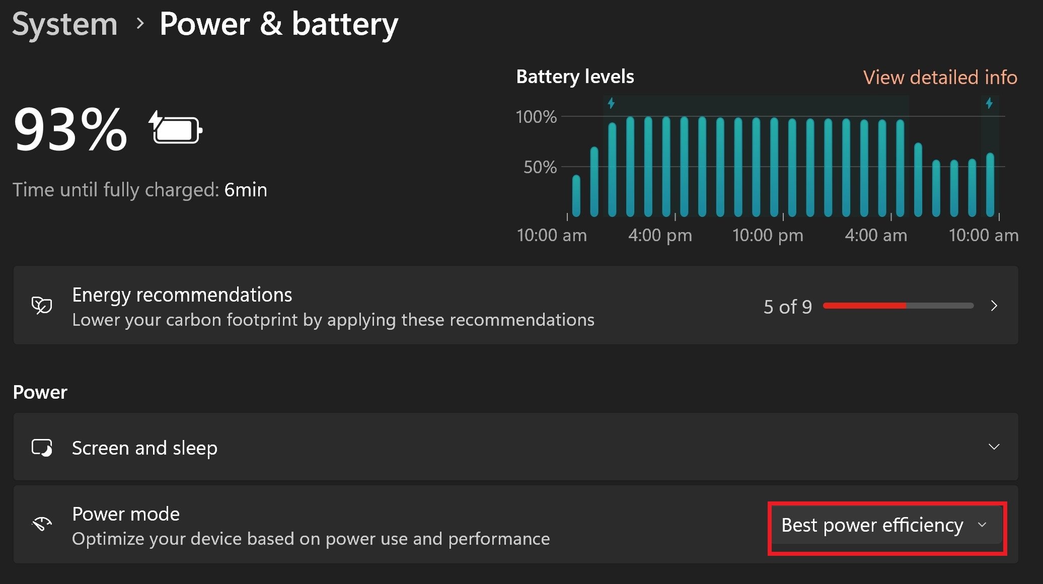

    Hi, the system probably overheated, disable Turbo Boost (see picture) in Advanced Power plan settings and use Balanced Power Plan, set to Best power efficiency in Power & Battery settings (see picture):

    Use the original Acer charger to ensure stable power delivery. Perform a battery reset using the pinhole on the bottom of the laptop. Clean the air vents and enable CoolBoost in NitroSense to improve cooling. Update the BIOS from Acer’s official support page. Use the Balanced Power Plan and set your system to Best power efficiency in the Power & Battery settings
